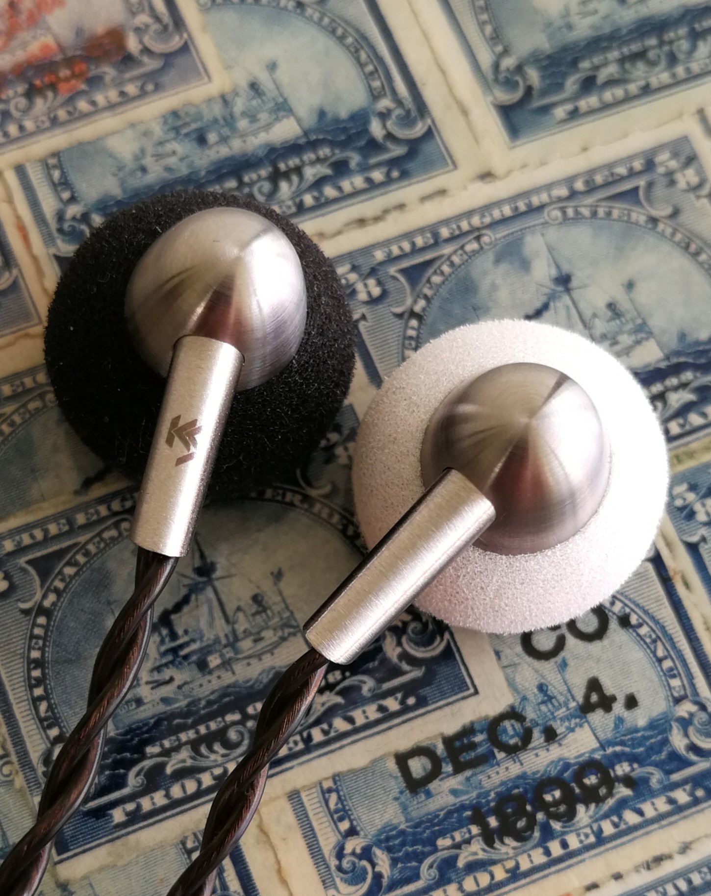

Ksearphone Bell-Ti 120Ω earbuds sitting on top of "Battleship Earbud" Case
This is a re-purposed watch travel case that I completely gutted and then re-applied cotton batting, thin foam padding, and black suede velvet. I also applied black suede velvet onto the outer bottom-side of the case. The top of the case was then decorated with vintage 1898 US Battleship Proprietary Revenue stamps (aka "Battleships") depicting the USS Maine sunk by an explosion in Havana Harbor, Havana, Cuba on 15 February 1898. These 120-year-old war tax stamps were affixed with three applications of decoupage glue followed by fifty thinly applied layers of acrylic polymer varnish which were lightly and finely sanded between coats, over a period of one month. I am still waiting for the varnish to completely cure before the final rub-out and polish.

Scott#RB23 5/8c Deep Ultramarine - US Proprietary "Battleship" Revenue Series of 1898
Engraved by Robert Ponickau. Frame engraved by Douglas S. Ronaldson.
These revenue stamps were issued to fund the Spanish–American War.
Painting of U.S.S. Maine by Frederick Nelson Atwood (1895); B&W Photograph circa 1897

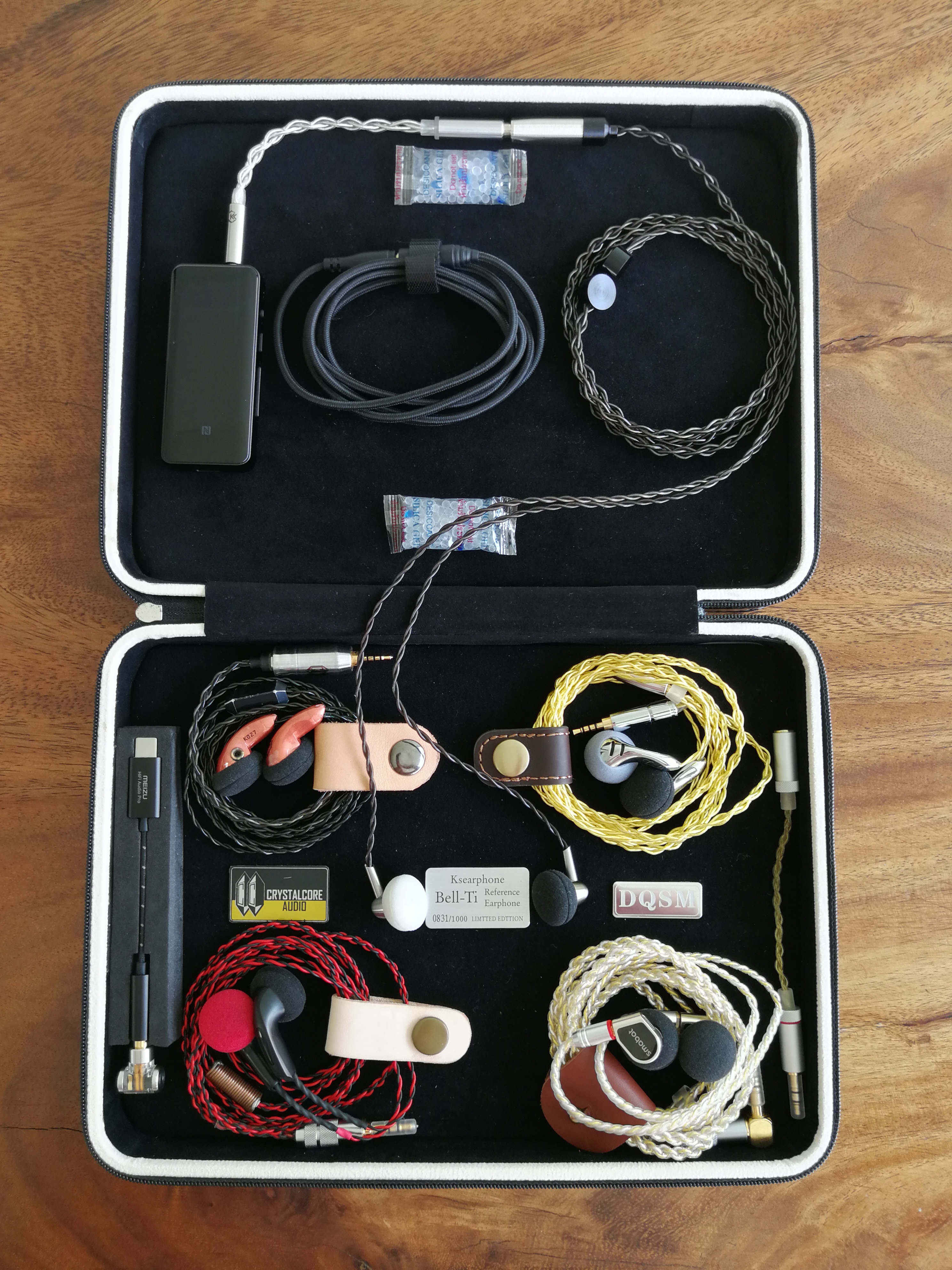

Connected to a FiiO BTR5 via a 3.5mm Balanced to 3.5mm Unbalanced Adapter. You may spy a Meizu HiFi Pro DAC headAMP; FiiO L26 3.5mm Unbalanced to 2.5mm Balanced Adapter; FiiO BTR5; ddHiFi DD DJ35A 3.5mm Unbalanced to 2.5mm Balanced Adapter; and an awesome 3.5mm Unbalanced Audio Extension Cable that I bought many, many years ago in Japan.
Top Left: Crystalcore Audio Kryptonite 150Ω Balanced 2.5mm Top Right: •D•Q•S•M••A•u•d•i•o• Turandot 16Ω Balanced 2.5mm
Bottom Left: Blur 美魔女 Beautiful Witch "Dark" 300Ω by by Wong Kuan Wae Bottom Right:
Smabat ST-10S Black-Gold 150Ω
Here is a pic of "Battleship Earbud" Case all ready for travel. So no, my earbuds do not travel loose within the case, but rather each in their own protective leather pouch :wink:
