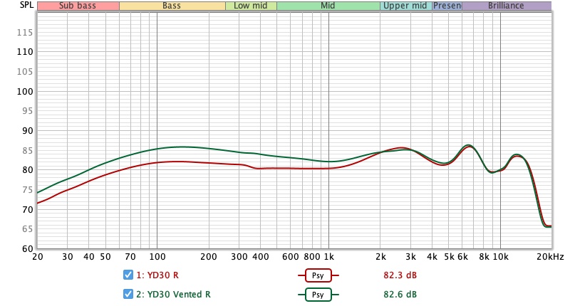

Lower quantity, leading to slight imbalance between lower midrange and upper midrange as well. I wanted to boost the bass and lower mid a bit to balance things out.
BA supported by bass tubes seems like a good idea to get great IEM sound on a budget. No electrical cross over either
In that situation, I would try to put in a port of some sort. You’ll actually lose deep bass doing what you did, but you’ll also decrease the pinna gain so the balance may be better to your ears.
Sep 3, 2022 at 7:55 PM Post #64,308 of 80,670
In that situation, I would try to put in a port of some sort. You’ll actually lose deep bass doing what you did, but you’ll also know down the pinna gain so the balance may be better to your ears.
Before and after, right from the coupler, without any realignment of graphs
I thought that drilling a back hole is already putting in a port? Or do you mean I need to do rivet mod?
Doesn’t have to be a rivet. Any sort of small tube will do, but Rivets are nice because of the lip and you can hide the janky-looking glue smudging that’s hard to hide without the lip. They are challenging to find narrow enough rivets for your purposes, but they are out there. Everything is a tradeoff. You can see that you’ve done exact What I’ve said though—except I stated it from an audibility perspective. Aligning the graphs somewhere between 100-600 Hz will expose it more visually speaking. The argument tends to be a center frequency between middle C and the A above it, but I like to ‘hang loose’ so to speak. Either way you look at it, the results are the same though: a warmer bud with relatively less deep bass/pinna gain. With your coupling method, you would think the green line would sound better assuming you haven’t bought an ear (Yet).
A hole is definitely a port, but it’s tuned for midbass/midrange in a sense and thus the gain in that region. If you extend that idea however, a wider port makes an open baffle bud. Extending the port’s length will tune is deeper just like a regular ported speaker—or doing a rivet mod as is the vernacular in the bud’s underground scene LOL. I personally like to maximize the frequency range, and tuning that port deeper would do that. With that said, it may not sound as balanced as it does now, but you can further customize that balance. Since you have the hole, the Rivet Mod would be the next thing to try IMO. Deeper bass is sexy.
You should buy an ear off of EA to see what you are really getting in a more realistic setting. You can get them for under $5. Maybe buy a few. You’d have a really nice rig at that point. It would still be impossible to really calibrate, but I’d bet you could get close enough with careful listening and there is no “standard” to really calibrate to anyway as there is no “standard” recording studio (Though some recording industry bodies do have some standards that are fairly related).
Sep 3, 2022 at 11:52 PM Post #64,312 of 80,670
Hey Ronion, thanks for the response. I think you are right. If I align the graph around 500Hz (where I consider "mid-midrange"), I can see that the bass looks exactly the same but the higher frequencies dropped.
Anyhow, I think it is two side of the same coin (more lower frequencies vs less upper frequencies). The point is (1) the contrast between lower and upper frequencies was reduced and (2) I did not manage to extend bass response. Whilst I am very satisfied with the upper frequencies, resolution, and soundstage, bass is still no where as good as FF3.
Though I must say that I disagreed with you at first about "losing ear gain rather than gaining bass" because the dogma that I learned from IEM world is that "opening back = more bass, until you over do it and lose all the bass", and "opening front vents = dropping the dirty boxy mid bass".
Re: measurement gig: I think the way I measure now achieve good precision, but no idea about accuracy. My hunch is that it reflects what I hear. Anyhow, I would buy artificial ears for my coupler.
Anyhow, my verdict for Nicehk YD30: Very good buy if you are willing to open it up and drill a hole through the back. In stock form, it sounds like an ER2SE or Tanchjim OLA with a more soundstage. Resolution is alright, 3/5. After modding, it is very good for all acoustic genres, and anything that benefits from large soundstage and does not rely on bass. The tonality is thicker and warmer, but the treble air seems to be more extended. Cymbals and high hats sound great.
I tend to look at things from an audibility or psychoacoustic perspective because that’s what ultimately matters to me and in truth it’s what actually matters to all of us when we listen to music. It’s the balance you are going to hear. Relative to the midbass, your sub bass is reduced audibly d/t Fletcher/Munson (ELC) and masking. You can maximize the visibility of that by aligning at 150Hz. Acoustically, you bumped the midrange, midbass and even deep bass. Just less deep bass than midbass and deep bass is generally harder to hear and the stuff that’s hard to get in a bud. You could also say that overall the deep bass may be more audible d/t the more dramatic decrease in pinna gain.
In all the preference data that’s ever been done, Deep Bass>Midbass and midbass is usually prevalent beyond Harman in buds. I think Harman’s IEM graph way overemphasized this because of their methodology, but it holds true in all the room preference data as well ever since deep bass was readily attainable. Buds usually have plenty of midbass, and not enough of the deep stuff. That’s where my comment really came from. I thought you wanted the deep, hard to reach stuff. To get the deep stuff, you’ll have to do more than a hole. I’ve been there and done that, so just trying to lend a hand.
The YD30 does not even have enough mid bass. That's why I said it sounds like ER2SE or Tanchjim OLA in stock form. Still, unbelievable price / performance for $15 AUD.
Of course, I did not mean to say "Look, I can drill a back vent, I have mastered earbuds". However, I'm definitely super proud that I can fine tune an alright pair of buds into darn good without resorting to EQ. Usually, this kind of "tuning" is reserved for influential reviews :dt880smile:. That's what thrills me the most. Can't wait for the next adventure when my shells and drivers arrive.
