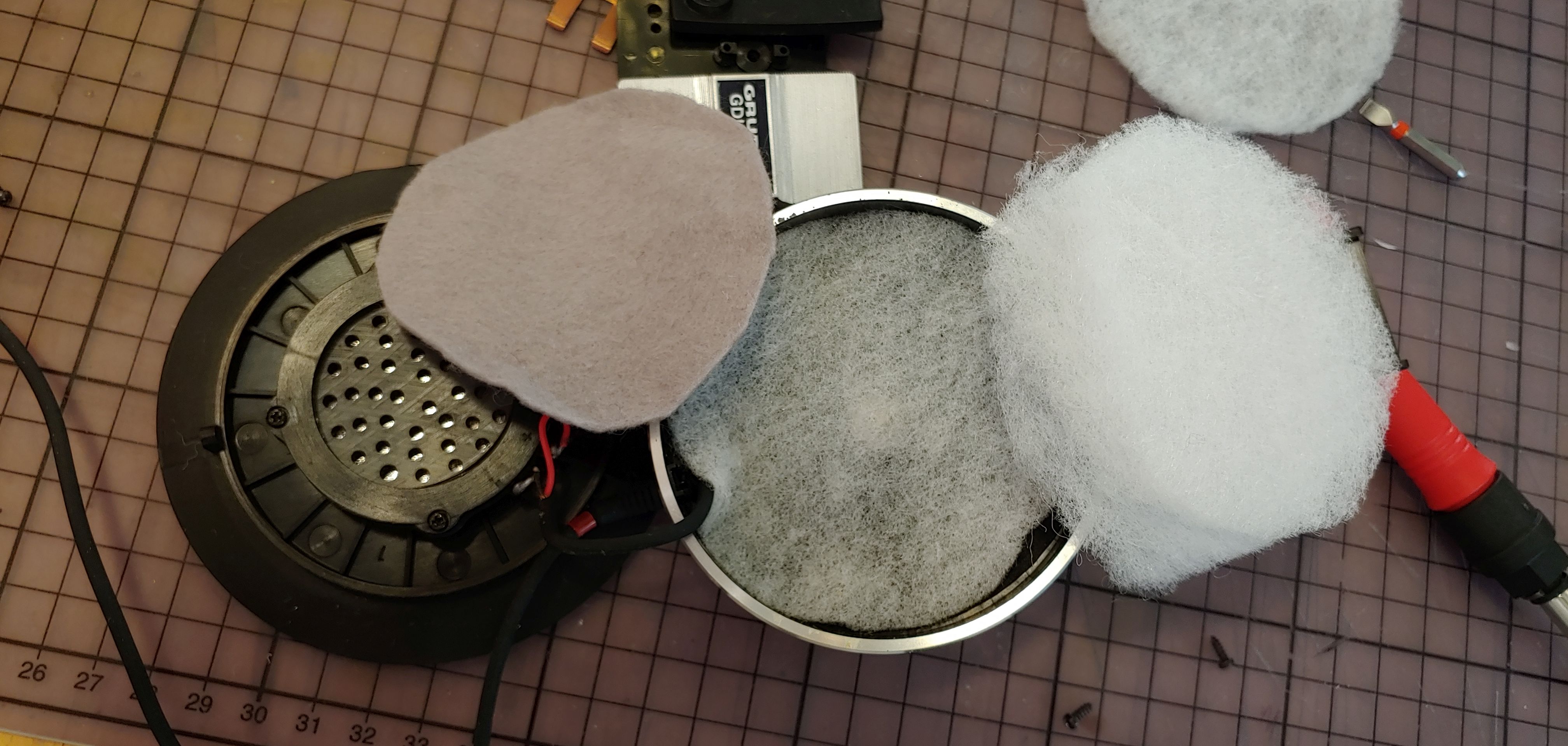

Today I got to open the Grundig GDHS-223 phones. They were due for a cleanup, so I can get them in general use. So I took some photos of the process, as well as the driver. Driver seems to be 5 cm aluminium coil. Anyone familiar with the Fostex drivers can identify it?
Inside was a foam disk turned to mush. I removed and replaced it with a sandwich of vacuum filter, speaker filling and a 3mm felt disk. Felt is towards the driver.
After the surgery can say that the cans opened up and sound more open and natural. Maybe the highs are a little harsher, I'll need to see if I get used to the sound or need to do anything about it.
Also replaced the pads from the original, on ear ones to over ear chinese 10 cm pleather + memory foam (3cm height). A lot more comfortable and a little bit more isolation. Also bass it better with these pads.
In any case, so far they are a nice listen.

Driver in that should be the same as the Fostex T20 first version from the same era. Earpads look good on that one. I've a similar Concept branded one that has one gimbal that doesn't quite create enough pressure on one ear. Fatter pads might help there... they do sound fairly good and not too hard too drive. Maybe a bit V shaped in response. Pretty fun.
