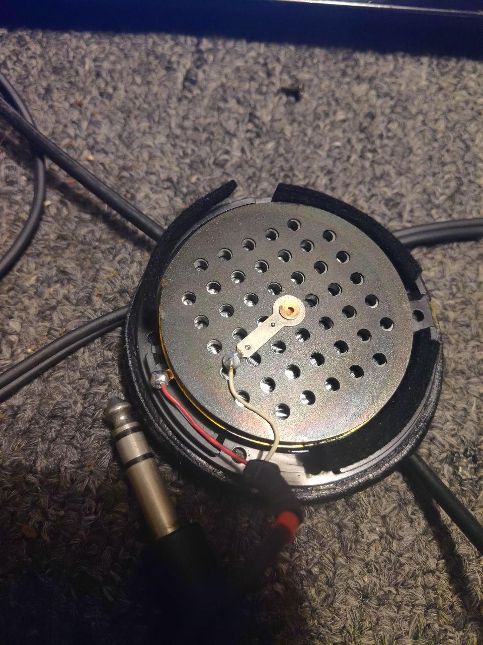

On another note, just finished recabling my SS-100... this is just a temporary fix for now as I have something way more complicated for it in the works. :kissing_heart:
