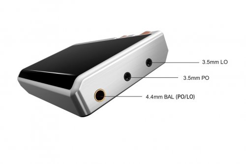

4. Dual line out from shared Pentaconn 4.4mm and dedicated 3.5mm
N8 offers two desktop grade line out: 3.5mm single-ended and 4.4mm balanced, and they are rated at 2.1V and 4.3V respectively. Besides, they are fit for audio equipment with input impedance higher than 10 kΩ. We planned to include balanced line out since the very early day of N8 development. When 4.4mm balanced headphone connector jumped into spot light and we decided to adopt it into N8, it become a perfect platform for full balanced line out because the TRRRS design enable a grounded balanced connection.

  4. Support 4.4mm balanced and 3.5mm single-ended headphone output
  5. Support 4.4mm balanced and 3.5mm single-ended line output

  11. Desktop grade line output: single-ended at 2.1V (dedicated 3.5mm) and balanced at 4.3V (shared 4.4mm)
