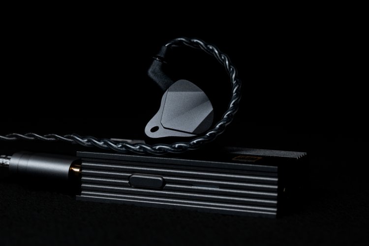

Summary of RU7 Features
- Fully Balanced 1-Bit Discrete Resistor Network DAC
- 1/1000 ultra-high precision TCR25 low-temperature coefficient thin film resistors
- Native decode DESD64/128/256, support PCM up to 384kHz.
- User-selectable All-to-DSD
- Users can specify DSD64/128/256 DSD output formats through menu setting
- Different DSD output settings might sound slightly different and drain more power when a higher-resolution output format is selected.
- 100 steps 3-segment High Precision Resistor Array Volume Control
- Hardware Volume +/- button
- TWO 6-layer PCB, digital and analog circuits on separate boards
- 3.5mm single-ended phone output delivers 160mW per channel at 32Ω loading
- 4.4mm balanced phone output delivers 400mW per channel at 32Ω loading
- Compatible with Android, iOS, macOS, Windows 7/8/8,1/10, and DAP with USB Audio output
- Type-C USB Audio, Shield USB-C to USB-C cable bundled
- High/Low gain control
- Compact and seamless CNC aluminum chassis with 1” 128x64 OLED screen
- 66mm x 24mm x 12mm, ~25g net weight.
- Green Leather cases bundled
- Optional USB-C to lightning cable CS-L2C (purchased separately)
