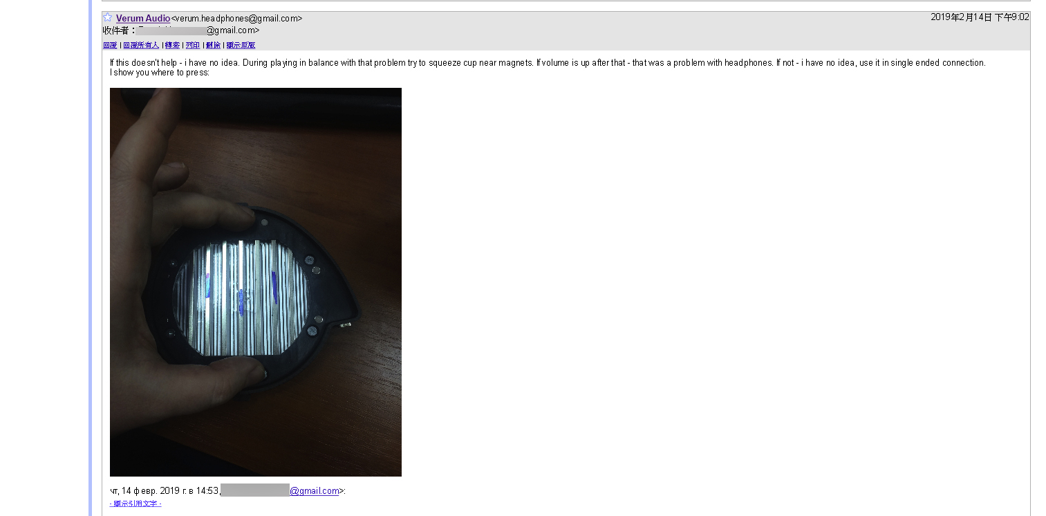

As request.
At 1:05 I point out the gap between the magnets holder and the membrane holder. This gap may becomes larger by time, because the strong magnetic repulsive force will gradually push the plastic holders away to enlarge this gap. The result is the magnets will goes more far away the membrane and weaken the magnetic field. Sound drops or cuts.
It is a DESIGN MISTAKE. Stop proud. Face the "VERUM". Take the responsibility.
As request.

I need to clarify - channel imbalance was due to bad contact between wire and membrane. EVERYONE who wrote about any problem to me received same answer - ship them back to me, I'll fix everything and send it back to you. You have 2 years warranty. Also, as an "I'm sorry" i include a free pair of perforated leather earpads that costs alone more then return shipment.
Magnets misplacements on ~0.3mm has no connection with that problem. In fact it's not a problem at all, yet it is fixed also.
That issue with sound cutouts and imbalance fixed long ago, unfortunately some amount of defective units were shipped ;(

0.3? You must be proud of your good observation.
The video show there are at least 2mm movement on ONE side. If the same problem distance happen on the opposite side. There are 4mm total.
I did not study science well but still know how the magnetic force drop rapidly at this CLOSE distance.
Bad contact between wire maybe the second reason to cause this problem. But I definitely sure the magnets misplace is the main reason! AND YOU KNEW THIS TOO!
The proof is, month ago you wrote this on the email to ask me fix the sound drop.
Funny this called "TRUE"......
If the cup plastic not strong enough to against the magnetic repulsive force, the plastic exhaustion will occur.Do you think all verum ones will eventually fail due to that issue?
This happen on my pair, I can't say others.

@Artyouth - height of the magnet bar is 3mm, and it moves maybe at 1\5 of it's height. You initially wrote me a message that in SE connection your unit works good, in balanced - one channel is silent. My answer was - I have no idea why it is so. You have 2 years warranty - if you feel that it is something wrong with your unit - write me a pm and i'll tell you a shipping address where to send your unit for repair.
p.s. Also, I'm pretty sure that you have unscrewed on purpose nuts a bit to make those magnet bars so loose. But anyway, I'm still willing to help though you have disassemble your unit.

@Artyouth, I performed your test in the video you showed us and the magnets stayed in place
solid as a rock despite me applying extreme pressure.
Whatever the problem was @Garuspik must have fixed it as he claims..
