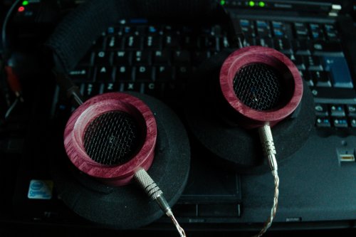

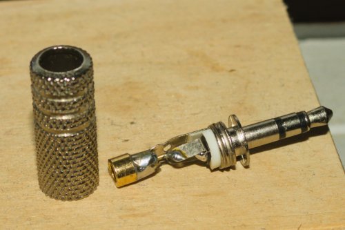

So my right side mmcx connector on my Grados started to cut off the signal, and no matter how much I tried to tighten the pin socket, cutting remained. I guess whole pin socket had somehow got pushed too deep inside mmcx connector and it couldn't reach the pin in plug. I decided to ditch the mmcx because no way I'd want to replace those mmcx connectors frequently, given that they're indeed that unreliable. So I replaced the mmcx connectors with standard 3.5mm plug socket. 3.5mm socket is very sturdy, snaps tightly in place and is most importantly very reliable, and some other headphones also use 3.5mm connectors so aftermarket cables are available, if I desired one. But as 3.5mm plugs are very common and easy to solder, it's easy to make my own cables aswell. I had to convert Grado stock cable into 3.5mm cable, and the Ourart mmcx cable I really didn't want to mess with so I made 3.5mm plug to mmcx female adapter so I can use also mmcx cables. Now my Grados feel so much more reliable and solid. :L3000:

3.5mm socket
Stock Grado cable with 3.5mm plugs and Ourart mmcx cable with 3.5mm plug to mmxc female adapter.
3.5mm plug to mmcx female adapter. Mmcx goes slightly inside the plug metal housing, and it prevents the biggest wiggling motions of mmcx connector, so it perhaps and just perhaps will last longer. But that's not too big of a concern as it's just an adapter, and it was very quick one to make. Works great for now, and isn't too bulky either when attached to headphone. Ourart cable is so much lighter than Grado stock cable, and makes headphones feel considerably more comfy on the head.
3.5mm socket
How did you get the female 3.5mm connectors to stay in place?
