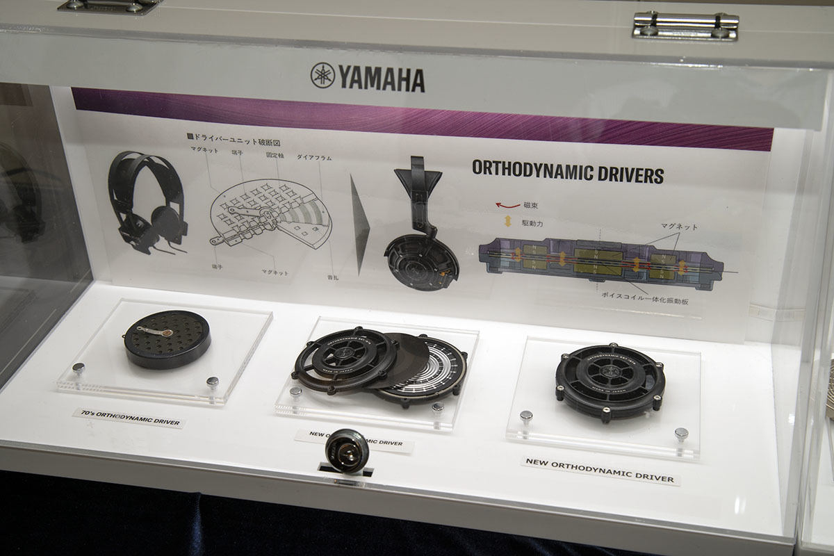

Yamaha's new headphones were named "YH-5000SE" and displayed in the Autumn Headphones Festival 2022 yesterday. Source: https://news.mynavi.jp/article/20220918-2457605/
Price estimated between $3,000 and 3,500-ish (Japanese domestic price). US price could be higher perhaps?
webp
50mm orthodynamic (circular magnet) driver ("New Orthodynamic Driver" as per Yamaha) with 34 ohm impedance. 320g weight.
Detachable cables, too.
webp
webp
Other pics from the cited news:
Drivers and cups look a bit smaller to my eyes than current planar totls. But I may be wrong.
Sep 19, 2022 at 1:28 PM Post #26,892 of 27,319
The drivers look beautifully constructed. That is the Yamaha difference. Excite.
Its hard to tell if the drivers are single or double sided magnet. And hard to tell if these are center pinned and/or non-tensioned. Modern planars are generally tensioned (aside from T50rp and Final Audio D8000).
Looks like they went for what looks to be a more open magnet pattern which Im guessing was not possible back in the day due to weaker magnets.
The spiral tracing has some interesting characteristics compared to the wavy pattern used by modern planar companies (aside from Final Audio who used ex-Yamaha employees supposedly to help design their drivers). I cant explain the difference but if a vintage ortho ninja would then that would be appreciated.
The price! Way out of my budget. I was expecting it to be less than Final Audio since Yamaha is a bigger company with economies of scale. Ill wait until its vintage then get one. :)
Sep 19, 2022 at 1:30 PM Post #26,893 of 27,319
I think this image, pretty much confirms double-sided magnets
