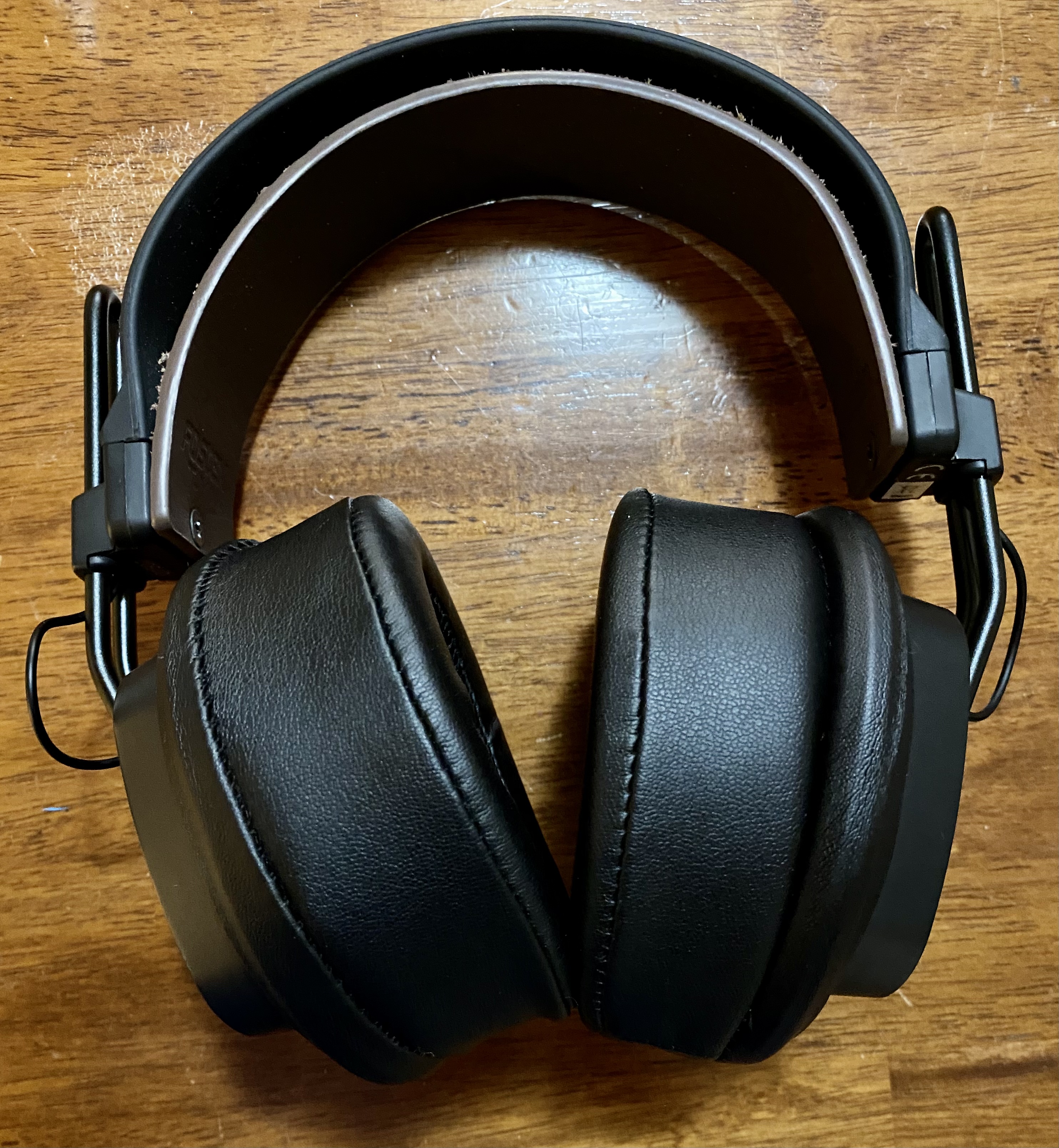

I recently got back on the modding saddle with a nemisis headphone that has been in the attic for about 3 years out of frustration.
Fostex T40RP mkII
It sounds very tastefully v-shaped. No bass bloat at all.
Almost surprisingly, vocal tonality is totally fine.. it just takes a bit of a backseat.
• Open the rear ports (remove plastic covering the vents)
• Inside of cups completely covered with adhesive felt - leaving just the bottom vent open (opening more vents cuts off sub bass slightly)
• Aftermarket Ori pads
• Paxmate around driver front (make sure to leave the side vent open)
• All stock driver damping removed (this was causing HUGE bass energy around 100-200hz)
• Replaced stock damping with micropore tape, leaving middle and top vents open
• 'Mad dog' style adhesive felt rectangle on back of driver
• Smaller adhesive felt rectangle on front of driver
• 1g of Twaron Angel Hair acoustic filler
• One circle of acoustic filler (arctic cotton/thermolam/whatever you have) inside the ear pad - this does 2 things - treble attenuation and 'spacer' that drastically improves sub-bass response.
• DIY suspension headband - makes the biggest improvement, obviously.
- More pics of mods here - https://www.head-fi.org/threads/fostex-t50rp-incremental-mods-and-measurements.618659/post-16356751

Maybe this is what I've been hearing? The bass is just too much for me. My T50RP mods are very unconventional, however, I transplanted the drivers into a Sennheiser HD535 frame with Brainwavz HM05 pads. I guess I should check the damping scheme.... I know there's arctic bamboo on the back of drivers, but don't remember if stock damping is intact. Grrrr. Can they be helped? I just wonder if bass isn't my thing and they sound perfectly fine to others. Even your measurements look "dark" and overly bassy to me.• All stock driver damping removed (this was causing HUGE bass energy around 100-200hz)
Haha. I was literally just thinking about this. Might have to try.I updated the mod to bring down the mid-bass.
Increased quantity of Twaron Angel Hair from 0.30g to 1g
In an open-back config like your Sennheiser, I would guess the sub-bass will be almost non-existant, but the mid-bass bloat should still be there, making a VERY wonky bass response... but that's my guess.Maybe this is what I've been hearing? The bass is just too much for me. My T50RP mods are very unconventional, however, I transplanted the drivers into a Sennheiser HD535 frame with Brainwavz HM05 pads. I guess I should check the damping scheme.... I know there's arctic bamboo on the back of drivers, but don't remember if stock damping is intact. Grrrr. Can they be helped? I just wonder if bass isn't my thing and they sound perfectly fine to others. Even your measurements look "dark" and overly bassy to me.
As soon as I opened up more vents on my T40, the sub bass just got a bit quieter, so I can only imagine it gets worse the more open-back it gets.
Also the online graphs of the TH-500RP kind of 'prove' this point to a degree - VERY poor bass extension on these.
I would put the drivers back into a mostly closed back shell, or close off almost all the vents on the Sennheiser, leaving three or four of the smallest ones open at the very bottom.
That might start putting things back in order, but I have no idea how it responds in that frame.
Overall the bass 'shelf' on mine is only 5dB louder than the top of the treble peak, so it doesn't sound obnoxiously bassy to me... although I was going for a bassy tuning for sure.
I've got so many neutral headphones, I wanted something a bit more bonkers going in a similar direction to DT1770 Pro or MDR-Z1R.
