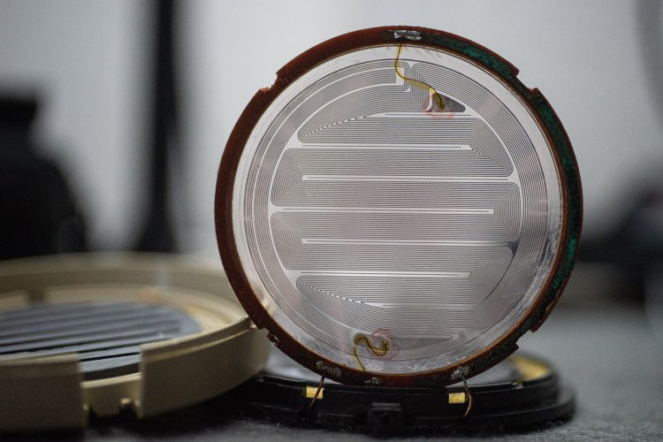

T30 needs some front damping. Brown circle felt is stock. I am replacing with this less obstructive felt (green). Inner diameter bigger so covers less driver

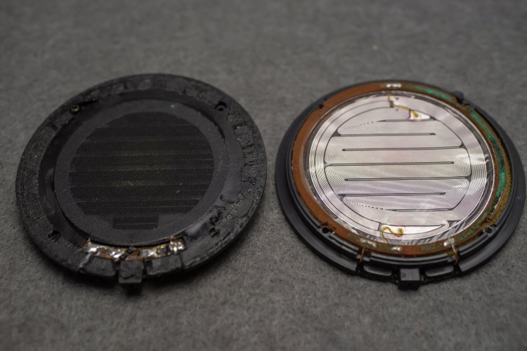

The cheap taobao shell I was gonna transplant the T50v1 drivers into cracked so instead I stuck them in the DT880-2003 shell I had lying around. Perfect fit!
May 7, 2021 at 11:11 AM Post #26,376 of 27,158
Yeah, all that's needed is a philips screwdriver to detach them, and the baffles are pressure-fit in so those were easy to remove too
