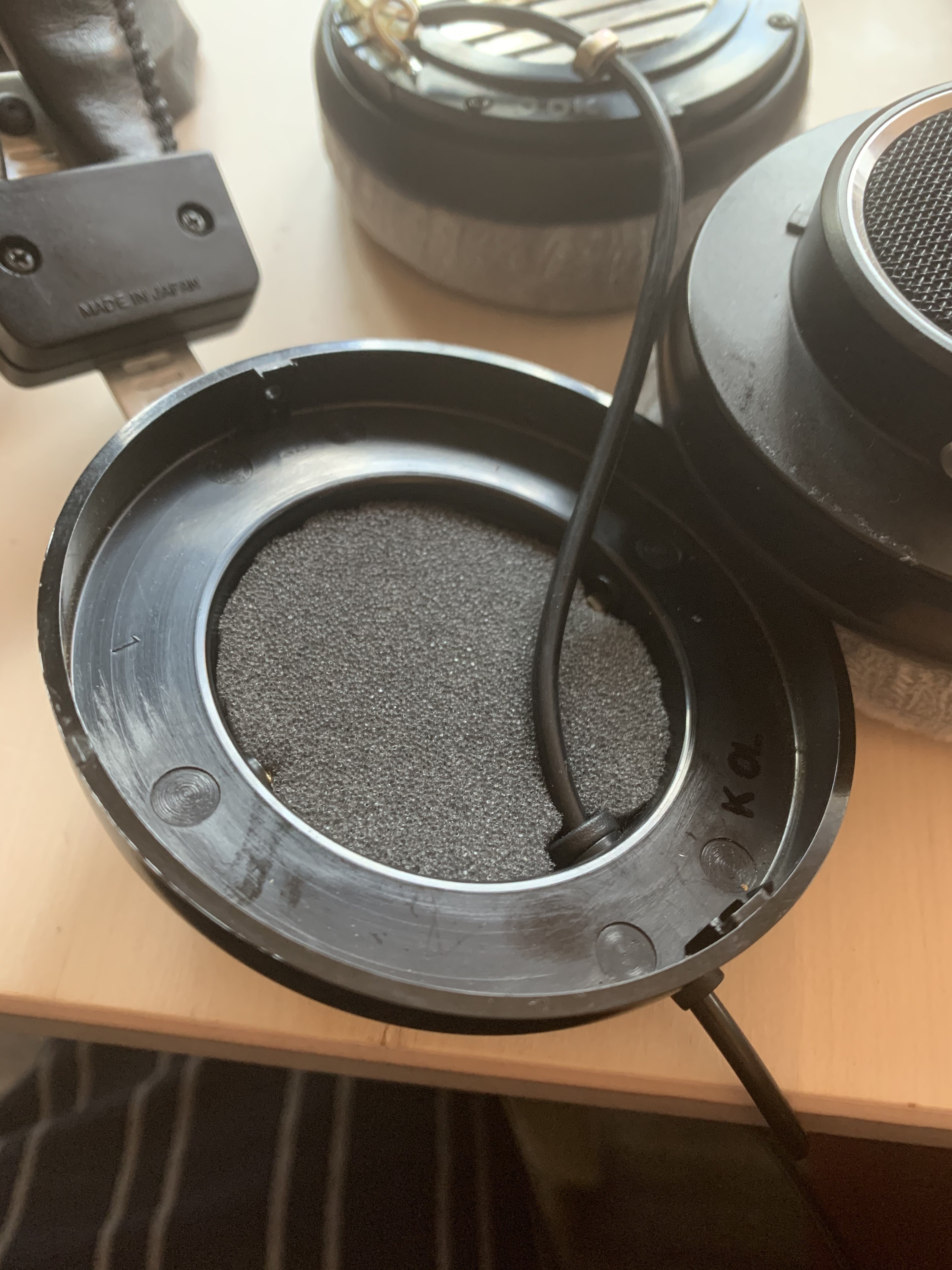

2lb foam in back of T30 cup. Not sure if there is airflow from possibly leaky front baffle so would like to address next to be certain. The foam here improved the one issue I had with previous iteration (undamped hybrid pads) which was slightly aback vocals. This mod pushed 2kHz back up to proper levels and now the phone sounds nice as-is. Mods to follow will be icing. I expect it will improve in technicalities with more damping like the Yamahas. Is that true in your experience with these serpentine style orthos? Ive not researched rp18 mods yet.

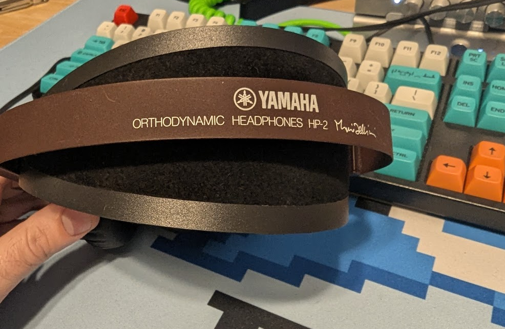

Ive only recently joined vintago ortho club and have had two distinctly different YH-2 drivers. Sintered had a little smoother or lighter treble with a “haze”/fuzz and warmer tone (lighter tensioned?), then my current which is smooth surface with chamfered magnet holes. dBel84 told me he was aware of a third with square holes.
Now researching RP18 within ortho round up thread and it seems there were multiple versions as well besides mylar vs kapton. Some had the spaced magnet rods, others had the circular magnet slab with slots, and one had a different style of tracing.
