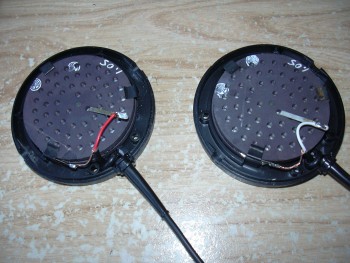

thought I would throw up the semi-ok pictures I took since I lost my last info with those.
On the following the final coup de grace tweak is of course Sorbothane.
If you are not using it yet you are not maximizing your headphones' potential. In most cases.
In comparison, quite simply the level of Sorbothane's effects makes Dynamat's effects seem like a complete unnoticeable joke.
Somebody else in here is currently noticing the Sorb fun but I will let them comment if they want.
" Smela " TDS-16 Sorbothane Mod Basics: ( Actually this black badge version I believe is also made in Kiev like the larger ones, but ignore that  since that is only information for geeks )
  1. Twaron Angelhair in rears = 0.02 grams
  2. Arctic Cotton disc on rear of drivers slit to slide under center contact tabs, fuzzy side to driver ( removed stock rear black fabric dustguard )
  3. 4 @ 5mm x 23 mm strips Sorbothane ( 1/10 inch 30D ) rear cups
  4. 2 @5mm x 26mm Sorbothane strips ( 1/10 inch 30D ) on driver edges split into 3 sections if necessary, total amount is what matters try to duplicate sides
  5. 4 small Dynamat squares per side to hold driver tight to baffle
  6. Aftermarket 65mm pads that have near identical inner opening and height profile to stock
  7. Buffalo leather headband strap ( replacement of hard as rock vinyl one ) double layered but left one single layer at screw point or it will crack the plastic plates.
^ this set has the really cool looking textured chromed metal band!!! Only one I have seen like that out of oh, I dunno... let's say a lot! LOVE IT
^ Arctic Cotton  slit to fit around tab
^ 0.02 grams Angel Hair
^ Sorb strips placement rear cups at 4 spots
^ Sorb strips placed around driver edges  in this case the total length is split into 3 spots avoiding screwposts
*********** For future reference if anyone gets a set of the smaller SMELA versions, and has the set with 3 clear wires and one red / or even loose drivers... the center pin of the driver is the positive +++++
*Ideally with some orthos as much sorb as can be fit, but obvious space limitations here.

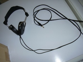

Currently recabling in progress for the TDS-16 with 26 AWG 30 strand Mil-spec copper and Paracord sheathing, the stock cable is not that great.
I do hear a difference for the better with my original one that used some massive Soviet copper interconnect cabling. That was the way the first set came to me when I got them years ago.
So this should come close to that improvement if not eclipse it.
Stock stuff is too old.
Kind of fun, now though I'll need to do a pile of things sadly. At least this experiment  let me figure the technique out for good ( only my second attempt ).
Lightly twisted, then 2 channel light twists run parallel ( periodic shrinkwrap ) along the main part instead of mangling the 2 channels together.
Less crosstalk? I dunno whatever floats your boat.
Feels right that way IMO.
Glad it doesn't look like a macrame 60's plant hanger like other stuff I have seen. Not my style honestly :P
Lightly twisted, then 2 channel light twists run parallel ( periodic shrinkwrap ) along the instead of mangling the 2 channels together.
Without turning this into the SS forum. A mild twist is fine. The really important part of twisted cable is the consistency of the twist itself. That tightly wound and braided flemish twist type cable is just a problem waiting to happen. Impedance and capacitance are functions of the conductors proximity to each other and the material and integrity of the insulator. Tightly twisting or braiding them makes it incredibly hard to maintain consistency in both features and can create more trouble than the twist is supposed to eliminate.
