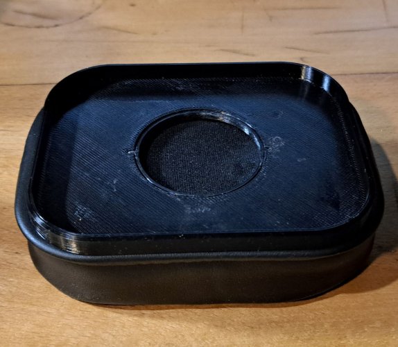

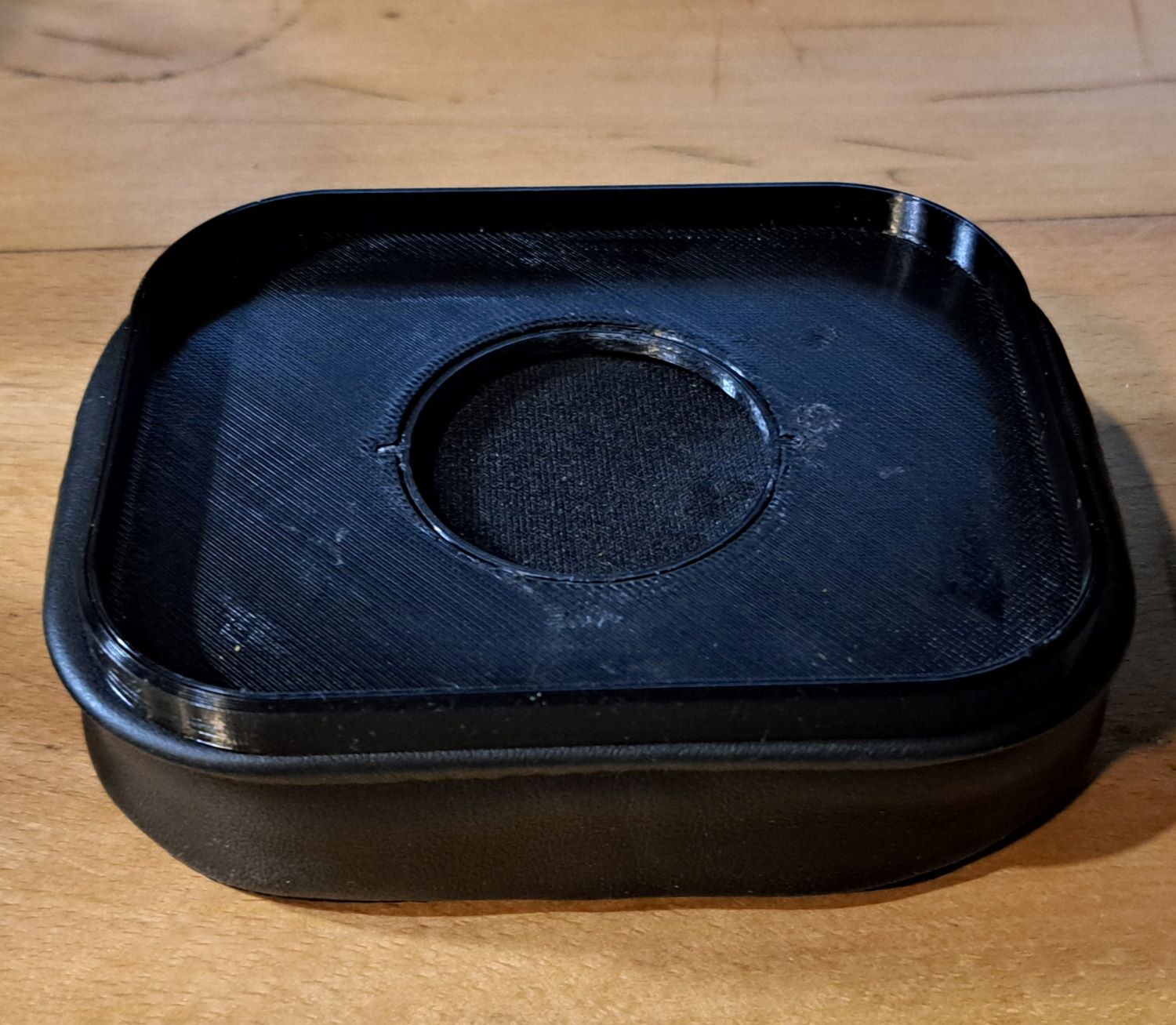

They came in this padded envelope, fixed on a cardboard with a tape. The really good news is that they have 32 ohm! just 9mm thick and 39 mm diameter. the black frame is fixed with hot glue and comes off easily.
I bought plastic cheapos on my way home in an computer shop.
The advantage is, they are really lightweight - now that they are ready with the SFI's together with the cable 190 gramm.
Here the drivers are glued to the baffle and holes sealed.
The cups are lined with a dense felt and the damping is the ring of visco foam filled with kapok (I love the neutral damping of kapok).
the pads are solid pleather and feel good and close tight.
I like the sound a lot and need just a bit more damping, because the mid bass is too prominent,
btw: I ordered more of the drivers :-)
