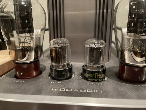

I scored a nice Hickok tube tester that was just serviced to test the batch of 6SN7 NOS tubes I scored for a buck a tube. Happily most were in the 3000gm range, and only one tested 1800gm. I popped in the Raytheon GTBs and was surprised at their increased gain. Great low level detail.The WA5 sounds way more transparent with the Raytheon’s. These are the side getter versions. I’m going to try these out for a week then swap to the Sylvanias.
