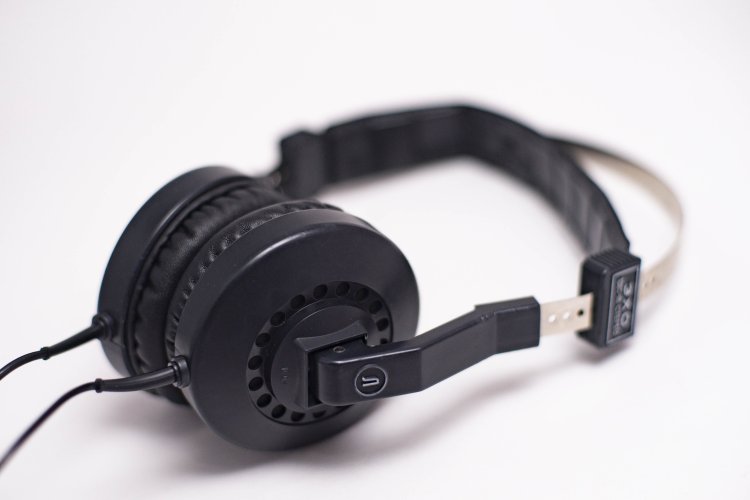

Hi All!
Vintage Elega FR-901C Flat Drive Stereo Headphone.
Driver full size: 73 mm., only membrane: 57 mm
http://20cheaddatebase.web.fc2.com/elega/FR-901C.html
■Price 13,500 yen
■Model Flat dynamic type
■Impedance 60Ω
■Reproduction frequency range 20-20,000Hz
■Allowable input 1,000mW
■Sensitivity 100dB/ 600Hz 1mW
■Cord
■Weight 390g (including cord)
■Released around 1978
■Discontinued Around 1980
