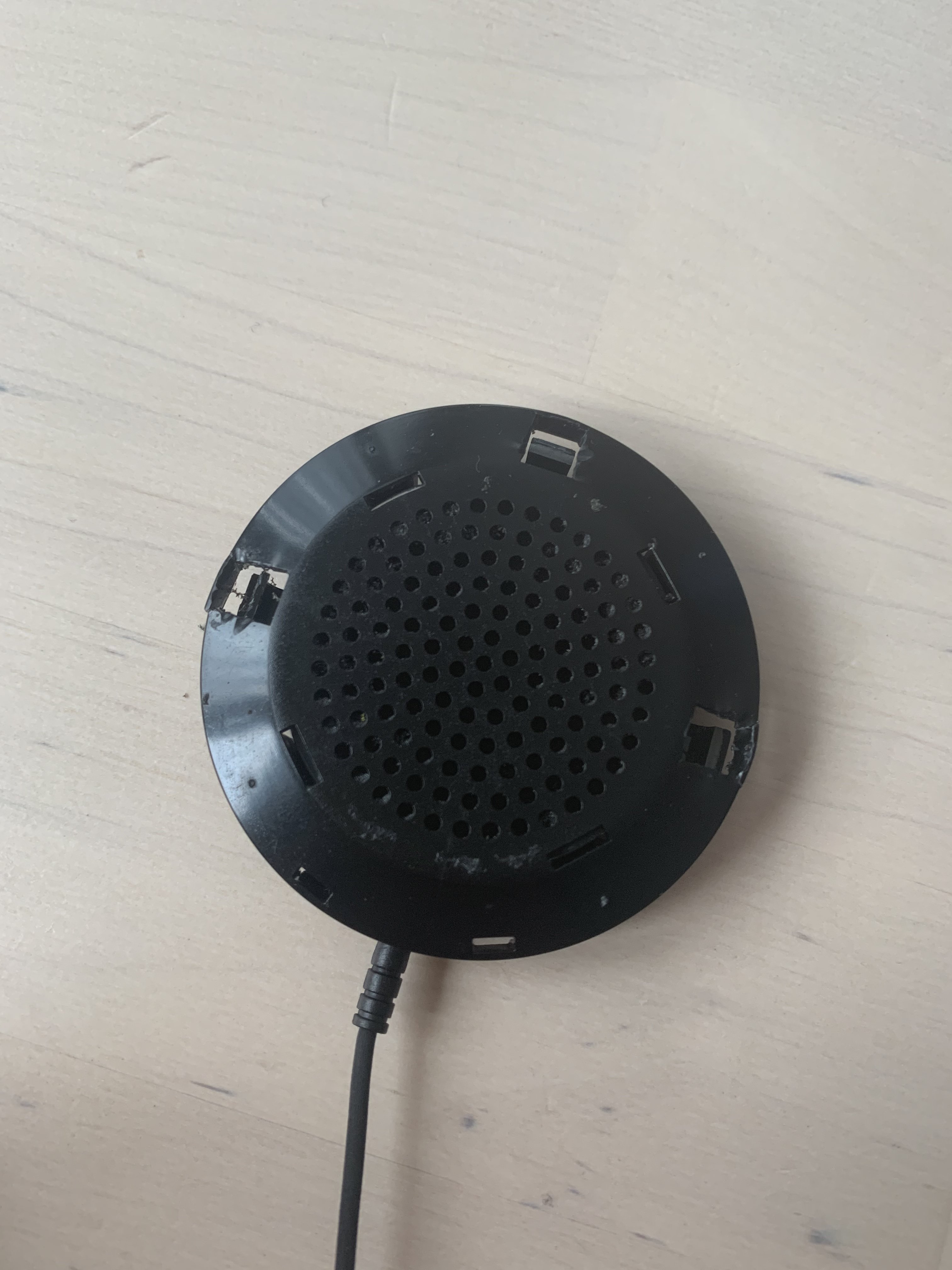

YHD3 needed dismantling because the decayed goopy foam is occluding holes everywhere. The driver “mesh” looks to be felt that’s held up well.
Certainly have broken all clips and heavily scatched up plastic of these recently NOS headphones. These are now keepers.
First cleaning then modding. Hopefully I didnt break with my oafish maintenance.

First attempt:
Felt-ish disc behind driver. Damplifier (dynamat) laid around edge of driver and front baffle. Then a circle of felt on edge of cups.

Had to rearrange green felt so cups could better clip together. Sealed up some front baffle holes. After I figure out pads then Ill play more with seal.

YHD3 mod caused bass to become more linear but lesser in amplitude compared to highs.
Id guess that disc felt is reflecting treble energy back, or is damping bass in combination with mass damplifer. Im going to remove disc felt and see what happens.
