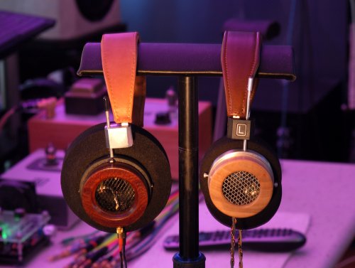

The amps i use are Xonar DG sound card, Teac UD-301 DAC/amp, Lyr2, Ember, Asgard2 and Teac AH-01. The DACs in addition to the UD-301 are Bimby and Modi2uber. And since you were so nice to post some pictures:
R1 in mahogany cups
R1 on the left, Magnum V7 on the right (fleasbaby built)
Nhoord Red V2 in Angsana cups
G1 in GS style walnut cups
