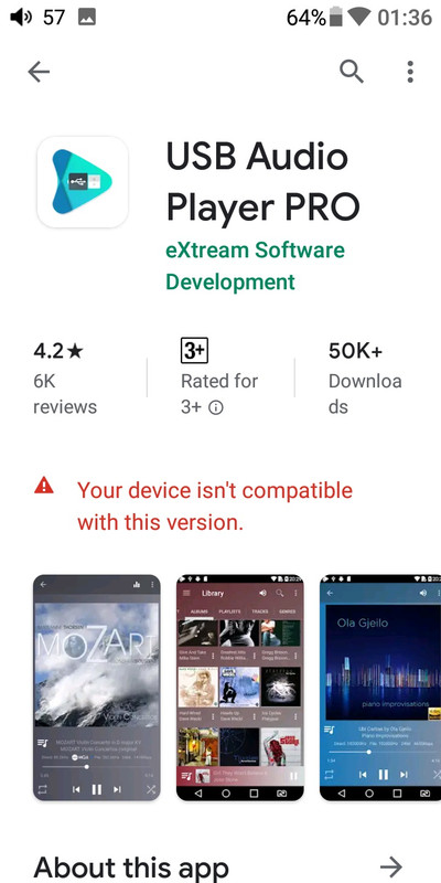

so to let you know what i am on about up above i'm going to try external links to my screenshots
Play store installed on my M11
you install play store on the M11 and this is what you find in the library section of the play store ie these are some of the apps installed on my phone but as you can see it doesnt seem to want to allow you to install UAPP
And this is why
BUT eventually i managed to install UAPP after being given a link to the APK - so finally ...... UAPP and Neutron and also Poweramp (all full paid versions from the app store installed on M11 .... only UAPP i got an apk link from Extream - the others i just used the library to install them)

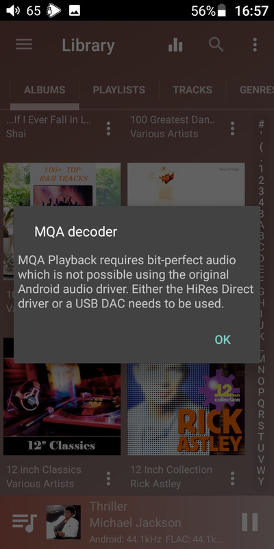

now you try and activate MQA for tidal and it tells you that you are working via the android layer thus the Hi-Res direct driver is not working - it will work if you use an external DAC/AMP but you buy a DAP because it contains all that built-in or so my logic dictates ie i don't want to carry too many additional external devices

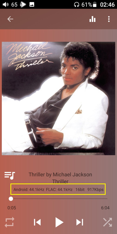

this what you see when you play via the DAP on UAPP - see the text in the yellow rectangle
DSD on UAPP in the DAP - downsampled to 44.1khz using the Android layer

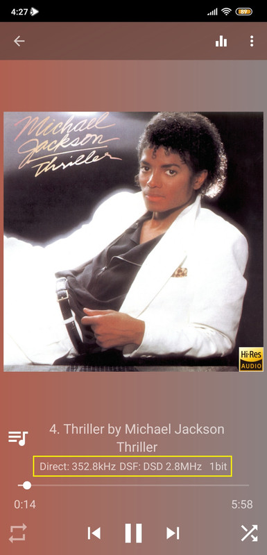

however move to my phone where the HiRes driver works perfectly and you see this - firstly its saying Direct and then the sample rate is not 44.1khz but its playing at 352.8khz which is the native rate of that specific file since it is playing via the Direct driver ie you are now fully utilising the DAC chips onboard the M11
all we now need is for app to become compatible with the device is for them to make the direct driver work with the DAP and i'm sure this is not a quick overnight fix - so i reckon though they will eventually do it so we just have to stay patient and we will have the software running properly on our devices
