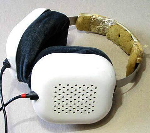

For quite a few years, I was wondering the phones on the attached pictures were a clone or the original design - until recently I came across phones featured in this thread. Well, as you see, they do have a striking resemblance to the Yamaha!
I bought two pairs of those Soviet-made 'phones new in the early '80s; they were called "isodynamic" and back then were likely the best ones produced over there and were most expensive. The sound quality was quite good (or appeared so) back then, but deteriorated over the years. Last year the first pair has developed destortions, and I disposed it; the second pair (pictured) is still alive, althouth barely. The cushions are completely gone, but my daughter still uses it on her Technics digital piano; in fact, she prefers them to Sens' 600 she has.

yvfed1's photos disappeared from his post, but here they are:
This is the Elektronika TDS-5M.
Fascinating! Yes, it looks like someone took casts of the Yamas and made the molds that made yours. Sounds like they may have copied the driver as well-- can you get us a closeup of that?
Replacement earcushions: the Stax SR-X Mk3 pads will fit, but they're not exactly cheap.
What city did these come from?
Deterioration: possibly the connection between the aluminum foil voice coil trace and the connector that leads to the cord, possibly due to electrolytic action. There's really nothing else in an isodynamic driver that could go bad over time. Don't throw them in the disposal before we have a chance to walk you through a possible repair.

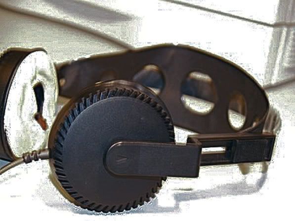

Smeggy, somewhere here HF member setmenu has posted photos of his Wharfedales. Here's one of them:
They're engineered in what I've always thought of as the best British tradition, using inexpensive materials with diehard cleverness, giving an unexpectedly good and often amazing result. They look primitive-- you're right, the magnets are the rubberized kind found in refrigerator magnets (though presumably stronger), and the voice coil is copper that looks like it was drawn on some Mylar with a metallic-ink Sharpie [EDIT: This turns out to've been an incorrect impression from the low-res photos available at the time. The Wharfedale voice coil traces are as precise as any other isodynamic's.] Yet it works and reportedly works well, which demonstrates something about isodynamics that is so far as I know unique: they don't require the levels of precision required by dynamics or electrostatics and can be scaled down in quality of materials without affecting the quality of the sound (though sensitivity and power handling are certainly sacrificed). I hope you find another Wharfedale and bring it here for our delectation. For that matter, I'd love to hear a Wharfedale or Leak isodynamic for myself.
Other isodynamic manufacturers take note: the Wharfedales are open-back! Whatever criticisms one might want to level at them, they at least understood the nature of the beast.

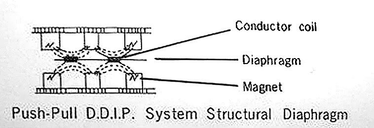

From the owner's leaflet packed with Radio Shack's ca.1980 Realistic Pro-30:
Not the most detailed diagram, but you get a physical sense of the diaphragm immersed in a concentrated, intense magnetic field.
