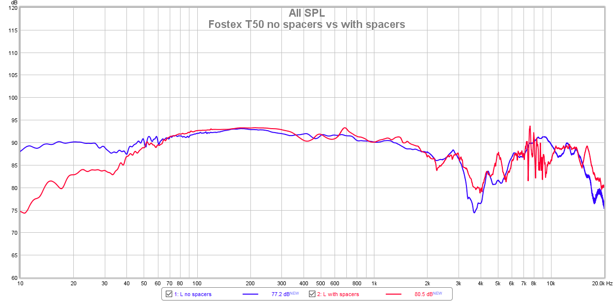

I posted quite a while back how my T50 was buzzing so I cut out cardstock to stick it around the diaphragm to add some distance. For some reason, today I felt like seeing the difference in measurements so here's that:
MiniDSP EARS; default headphone compensation, no smoothing applied. These are with MrSpeaker Ether C Angled pads on which generally has a mild lower midrange to mid-bass hump and a dip at around 4 kHz with all the headphones I had them on.
Response looks a lot smoother. Bass extension has largely increased. I can't say I can hear the difference in bass though even it shows such a significant difference. Maybe I can in listening long term but I'm not sure if I will keep it like this because the cardstock spacers got rid of the buzzing.
