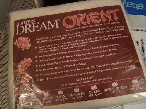

could this be the ultimate?
could it be?
Nicely blended, carded to loosen, crosslapped, needlepunched to give uniform thickness and resistance to shifting ( just like the best other quilt battings like Arctic materials we have tried )
In my quest for finding loose silk filler with consistency of loose cotton, I came across this.
Previous Hobbs Rough Silk batting was resin bonded. This looks like the silk in it is not, so loose
Bamboo... well had experience with that.
Cotton too obviously.
Botanic Tencel apparently is organic based taken from eucalyptus pulp fibers.( supposed to be similar to silk fluff )
Not sure the ratios.
http://www.quiltersdreambatting.com/dream-orient.htm
More to follow with damping trials
