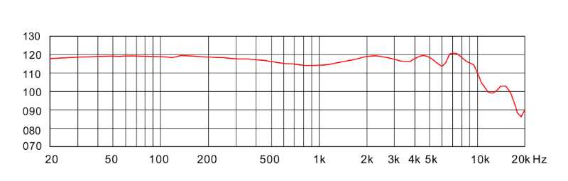

Before anyone asks, no, I don't have DM6 to compare.

Interesting you have a spike at around 12K. What coupler and tips are you using?

Using the Vibro Veritas compensated. I always use foam tips for consistency when possible because they fit more securely in the coupler (silicones tend to pop out).

foam tips are more comfortable when measuring, indeed. but they tame 8kHz and 10kHz (and maybe others) resonances a few dB.
after trying some methods to keep silicone tips into the coupler (press with rubber end, clips..), found you get the best results by using a good amount of bluetac around the shell and the coupler to keep them together; no distortion added

I also use foam for consistency. I'll run it through with silicone (stock tips) tonight.
