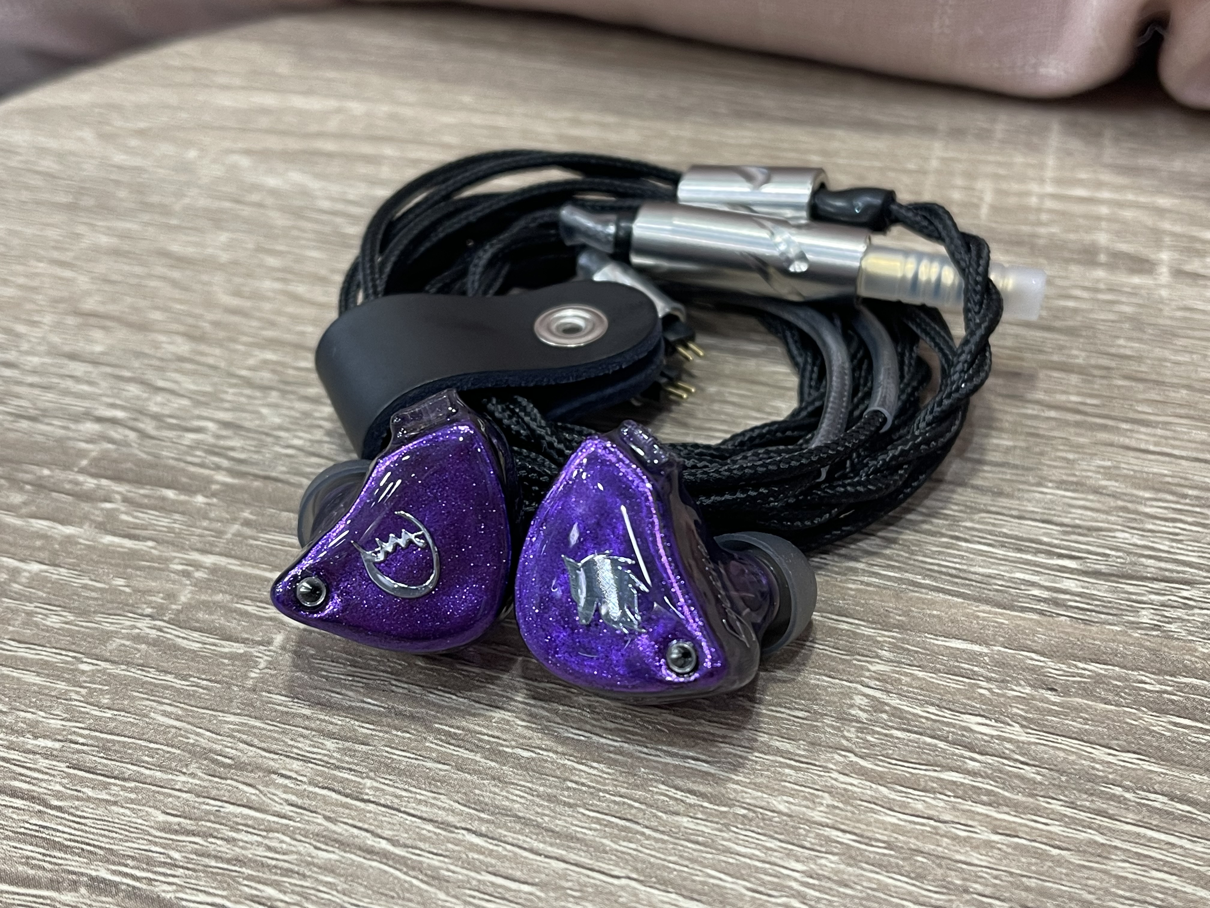

This is how I lost approx 1000$ this month.
So my good friend @Ace Bee got to know that I have got the coupler and just trying my hands on different stuff. That's when he sent me his unit of D's Audio First Heart, a single DD IEM that had a super amazing sound. The clarity, the tonality, the bass, everything sounded so great on the set that I instantly urged him to help me get one as well. While I was exploring D's Audio Catalog on Instagram, I came across an IEM that I instantly liked by its looks, it was named D'S Audio Fire Phoenix, so I asked Ace to help me with the price. When I got to know it is priced at 9680HKD approx 1300$ i lost my crap. I was like let's save up and we will get this one, let's skip the First Heart since Ace Bee already has it. I was thinking about it, but i couldn't get the design and the look of the pair out of my mind. Secondly i was thinking since this guy makes a 500$ product(First Heart) this good, I wonder how amazing his flagship might be. well, i know i might be wrong here, but i was having great intuition inside regarding the pair and the maker as well, that i planned to go in blind. Ace Bee was also getting a pair for himself(of a different customized IEM), i asked him to help me grab the Fire Phoenix. And here it is all prepared and shipped for me. I just can't wait for another 10-15 days when this beautiful IEM reaches my hands. I am all fingers crossed that this better sound great!! and Honestly after First Heart, i am super positive about this as well!! Will post some impressions once i receive it, but this is how i am almost a 1000$ down this time :)
Here's my Phoenix <3
Man the Fire-Phoenix logo right on the face cover is so powerful!!
& here's the customized Lycane for Ace Bee it's a 1DD+4BA hybrid he chose, I wanted a single DD so mine is the Fire Phoenix!!
