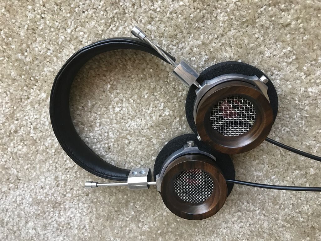

  Grado SR80e build complete!  Wood cups, aluminum gimbals, leather headband from Rholupat.  They provide great customer service and everything got to me in about 2 weeks which was faster than i expected.  View my build:  http://i1106.photobucket.com/albums/h368/weissja/audiophile%20stuff/DDE6E193-099F-468C-9209-2D86E36B9C9A.jpg
I wish my purchases would get to me that quick, most of the time it takes 3-1/2 to 4 weeks.
Nice build, did you do two different builds? Rosewood an Tamarin cups

Yeah i liberated drivers from my SR80e and put them in rosewood cups, and I also put a pair of Symphones V7 drivers in some spalted maple cups.  Both look good, but i think the spalted maple cups are far more unique.  They're also kinda special for me because it was my first time soldering cables to drivers.
Nice work, how do the V7 drivers compare to the 80e drivers?  The V7 is the only driver I've yet to try.

Definitely apples and oranges, completely different sounding drivers.  About the only thing I would say is kind of similar is the soundstage, but even there i think the V7s might be a toucher wider.  The V7s have more airiness to them as well.  They have more bass.  I hear deeper sub bass but also some subtle bass in places i never noticed before through the Grados.  With that said, i'm not one of those who thinks Grados have no bass, it's just that the V7s have more.  The V7s have a much more refined and polite presentation of sound, versus the rather aggressive Grados.  There is no accentuated mids on the V7s like on the Grados.  I'd say the Grados are a bit brighter.  All in all i prefer the V7s to my SR80e build aside form the energy of the Grados, which the V7s lack a bit.  There will definitely be moments where i reach for the Grados, but I overall the V7s to my ear sound like a much better headphone (at least for my sound preferences).  As an aside, i had a chance to compare the V7s to my buddy's older generation Grado RS2s last night and the V7s held their own.  I'm gonna say the RS2s may have been the winner but not by much.  The RS2s kind of had the energy of the SR80s and the refinement of the V7s.
I am curious to hear the Ypsilons, Epsilon R1 and Nhoord drivers.  Based on what i've read I think my next build will be with the Epsilon R1 drivers.
