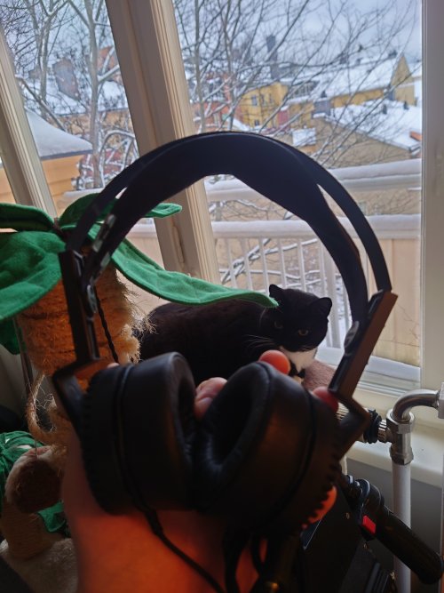

Hello anyone know about this headphone? And is it still related to the yamaha ortho series? It is currently being auctioned at my local forums, the seller said it is dynamic driver though he might be wrong because he is just a reseller.
Those are vintage Russian (Soviet) orthodynamic headphones.
Those look very similar but not quite the same as a pair of Yamaha HP-1, but that's all I know
Nov 18, 2023 at 6:12 AM Post #27,068 of 27,310
Yes, they are a TDS-5 (ТДС-5).
No, they are not really related to Yamahas, however, they are a 55mm pinched ortho, so they do belong in this thread for sure.
