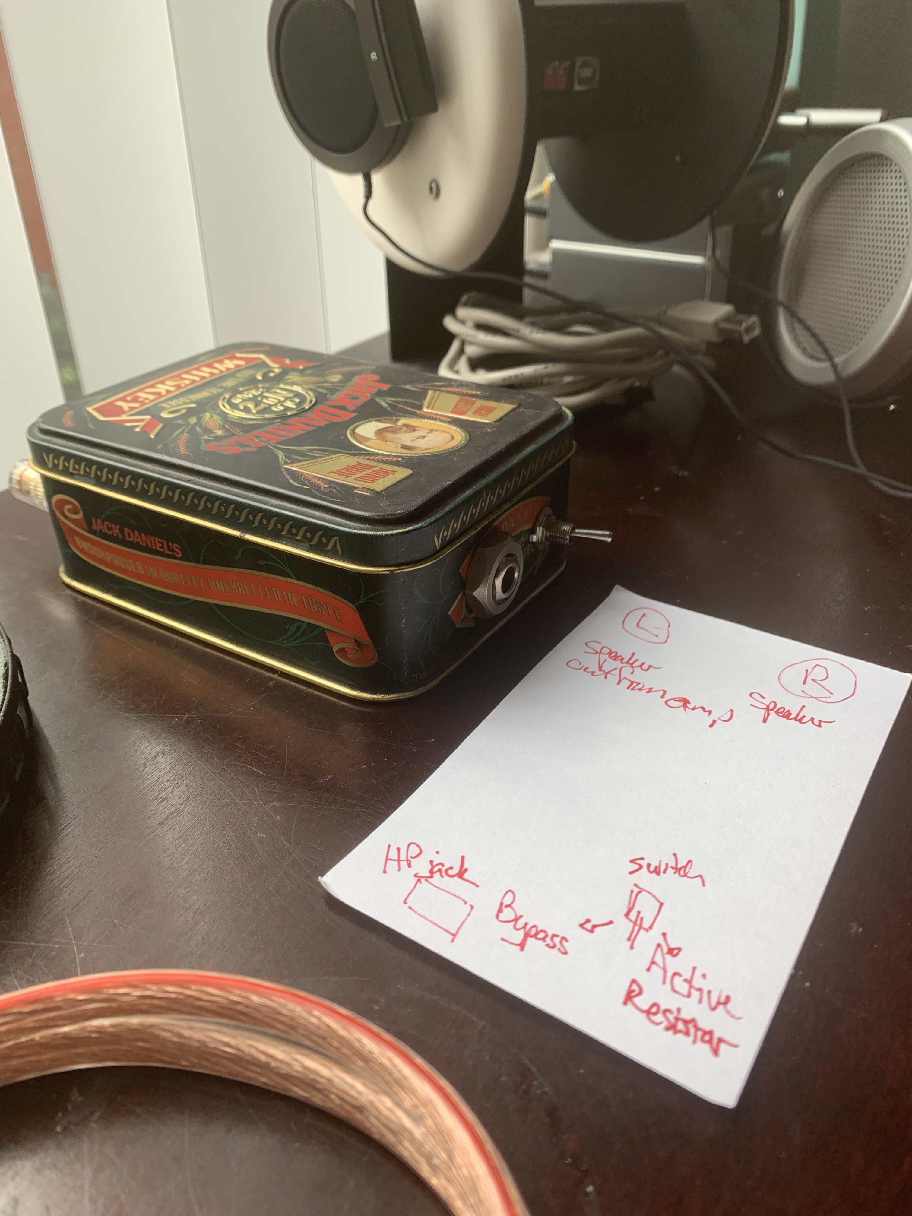

I sent @dBel84 my T30 for bad wire connection repair, which he fixed for free. I also sent him a headphone as gift because he would not accept payment. And look what I got back in return! A lovely speaker to headphone adapter for my diy Pass ACA amp, and a YHD-2 made from my old YHD-3 drivers. I gave the drivers to him so he could use but I guess not. I bought the YHD-1 after dB dropped the YHD-2 in the mail as a suprise so I did not know Id end up with two YHD. You guys are the best. Ill ask dB if he wants the YHD-2, otherwise Ill pass on.

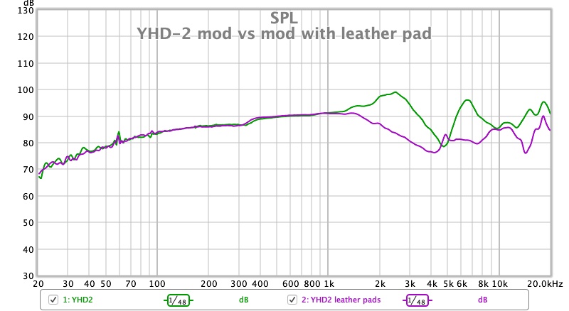

Quick mehsures. No mods, except slapping some leather pads on top of stock foams for the "leather pads" measurements. "On top of" means there is not an actual seal, just held in between stock foam pads and ears by friction/pressure, which means there is more bass to be gained with properly sealed pads or damping mods to back of driver.
The big thing vs the center-pinned Yamahas is the lack of treble peaks (with leather pads). Also, not sensing any immediate ear fatigue, which means more likely to have less serious ringing in the mids-highs like in the center-pinned Yams. The ringing seen in CSD graphs of YH/HP series appears to be inherent in the driver and not a consequence of the small closed cups (same ridges are still apparent even when drivers are transplanted to open cups). And the higher you go up in tiers the worse the ringing (I went from YH-2, YH-1, YH-100).
These are good first impressions. With the leather pads it's obviously too warm, however that is a great place to be pre-mods as its easier to add trebles than add bass (without resorting to front filters). I'll be looking to use dense foam pads, to get a nice balance, and to have an open/airy sound.
Will add YHD-2 impressions and mehsures later.

The frequency response measurements may not be good. Supraaural headphones are difficult to measure with EARS due to getting a seal with shallow pads and silicone fake ears and usually requires a bunch of trials to setup correctly. I took these measurement of YHD-1/2 with just a few passes since I know these headphones are not in final mod form, and because stock form is going to be near impossible to get a good seal for good measurements with EARS. Subjectively, tonal balance sounds more linear than appears on graph. Better seal with soft human ears... And there is theory (can't link to other sites in North Korea-Fi) that 2kHz with supraural headphones sound different (less severe) in actual use vs measurements. YHD-3 was imo the best sounding Yamaha I had tried and compared it to Koss 95X (except ortho has much improved bass dynamics). I think the open back version YHDs may be even better, we'll see. I don't have 95X anymore so will have to compare to Fostex T30 and TH500RP instead.
These YHD-2 are definitely damped. I had to switch my amp to high gain. I'll be ordering some Geekria pads that I've found work fine getting seal with EARS, so I'll have better mehsurements later.

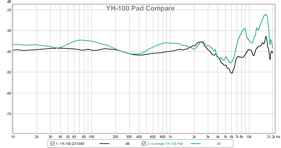

ZX1000 earpads showed up. Check out measurements versus other earpads on YH-100:
ZX1000 has sloping peak at 2.4kHz but it's not really noticeable, and treble is nicer and not as splashy I think.
Here is YH-1 versus YH-100, both sporting ZX1000 pads. I feel like the gap has closed some with this last pad iteration, YH-1's sound so good with ZX1000 pads, imo. There is still that last bit of detail out of the YH-100's, and tiny bit of cleanliness, but it's less apparent with these pads, imo, and these pads are pretty cheap. I will have to swap back to flat pads for YH-100's, but so far I think it's improvement for both headphones. Too bad there's a portion of the pad that isn't genuine leather...
