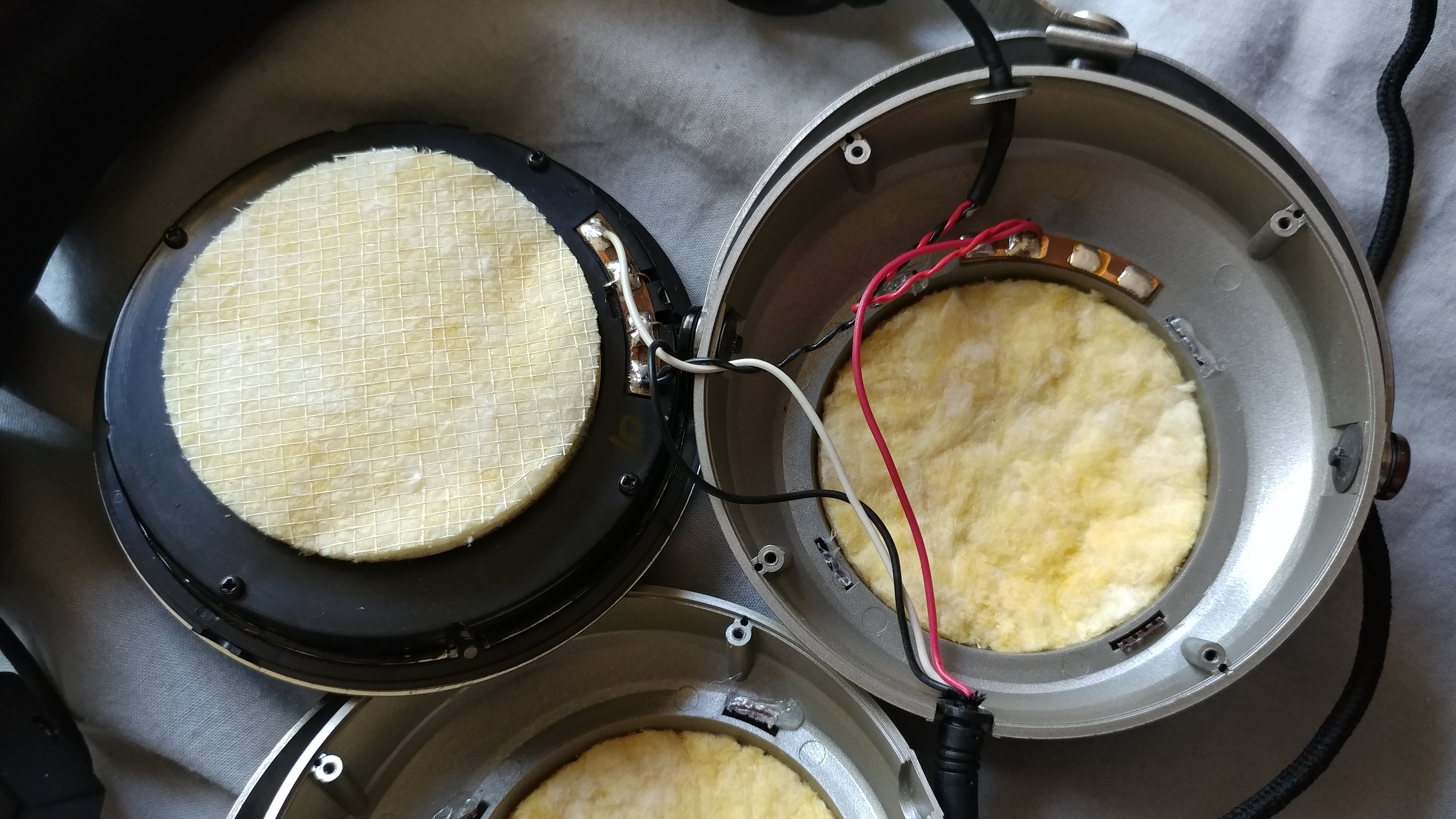

Seems like I'm the latest owner of the HP-500 that's been passing around.
I opened them up and it's a Mylar diaphragm!
The earpads are soft rather than the hard pleather that came on my T50. Stock T50 and stock HP-500 earpads side by side in both pictures. T50 on left, HP-500 on right.
Something kinda interesting. The front baffle of the HP-500 is reflective, whereas on the T50 it's not. T50 on left, HP-500 on right.
Edit: Well, no wonder why the HP-500 fits quite a bit tighter on my head. It has less headband adjustments! Well that and it has more clamping pressure. The Fostex T50 has more headband adjustment - 2 notches lower (11 notches shown on max adjustment on T50, 9 notches shown on max adjustment on HP-500). The notches are on the outside on the T50, inside on the HP-500
Earcup and rear porting.
Left side wiring.
Edit: Another thing I noticed, there's a piece of tape right along the middle on the back of the driver. The may explain the heightened treble response I heard. Because of the glue residue on the tape and around the back of the driver, I assume the tape was put on like this during production.
Magnets
Oh and they have a buzzing problem which I'm not really surprised at this point. Have to cut out my "spacers" that I've drawn a while back for the T50.
I'm using Shure SRH1540 earpads on these. It's a bit hot up top so I cut out a donut from a sheet of felt to mediate that. Seems to help a bit from subjective listening. Will have to measure that when my EARS measuring system arrives.
Edit: Now using the MrSpeakers pads.
Left side wiring.
Magnets

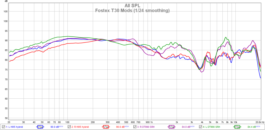

Fostex T30 measurements (matched at 300Hz @90db, 1/24 oct smoothing applied, default compensation):
Also, pay no mind to the blue cross-hair. It's just the cursor.
Jun 7, 2018 at 3:18 PM Post #25,841 of 27,319
At a glance, the T30/DT990 mod seems to be the 'best'.
Good stuff.
How are those brainwavz pads? By the looks of it, they cause a bit of a mid-bass hump?
I've only got some cheap stock knock-offs from eb@y, but that's 99% of my experience with these pads with almost any headphone.
Jun 8, 2018 at 2:02 AM Post #25,842 of 27,319
Good stuff.
It does seem like it. I do think the treble is a bit too much. I much prefer the treble response with the Brainwavz hybrid pads.
The brainwavz pads are pretty good. Very comfortable. Well, it seems more like they're causing the midrange to recess rather than creating a mid-bass hump. The driver sits further from the ear, more so than the SRH1540 pads I used with the DT990 Pro mod. There is a midrange imbalance with the DT990 mod which I think may be caused by the excess cabling I left in the earcup (in case if I didn't want to go through with it and use the cable for another headphone).
As of right now, I just EQ up the midrange of the T30 with the Brainwavz hybrid pads (+3db @900Hz, +3db @1kHz, +3db @1.5kHz, and +2.5db @2kHz). I think due to the much bigger opening of the T30's rear port, it's a much wider soundstage than with the DT990 Pro chassis.
