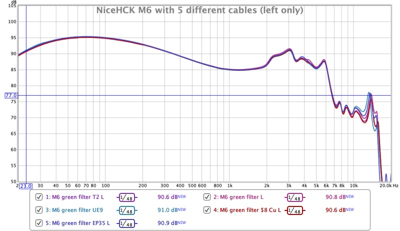

I measured the M6 with 5 different cables: stock, Tinaudio T2, $8 copper NiceHCK, $7 silver from another third party, and the silver cable that came with the NiceHCK EP35. No difference found (within error; the wiggles above 7 kHz are unreliable).
I was wondering would a csd or impulse graph also show the exact same results. Freq resp Graphs rarely show anything different yet people still find some cables to make a difference.
I am still skeptical myself but I thought it would interesting to see what different measurement types show
I never believed that cables make any difference to a sound till I tried the NiceHCK 8 core copper cable and can definitely hear a big difference in the bass.
However I wouldn't attribute it to the cable material making a difference, the NiceHCK cable is thick and heavy which I believe affected the angle of the nozzles pointing to my ears or because of the stiffer ear hooks affected the pressure against my ear canals.
I experienced it with my Ostry KC09, which are dynamic drivers and are not as affected by impedence.
When I swapped the stock lightweight cable with a similar lightweight cable (Tinaudio T2) I couldn't hear any difference at all.
No impulse graph yet as I am not yet so deep into the topic. That's why I just reported the observations (matching graphs) and no interpretations. But from what I read is that some people hear differences between cables, although most say they are subtle.
