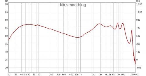

Measurement of Jabra Elite 65t
It's rather different from RTING's measurements, which also show the channel imbalance between both tracks. For me, the bass imbalance is quite obvious on my unit, although this could be down to my own hearing combined with wear and tear. A few posts back I mentioned that the pressure vents and nozzle need to be cleaned after a few months of use, or else the sound will become even more imbalanced.
They also updated the review back in March 26 to mention reports of users getting hissing, but thought it wasn't worse than other devices out there. They also don't mention anything about clipping.
To me, the hissing is bad, but still bearable, what really irks me is the clipping distortion. I had noticed it on the store demo's Jabra Elite 65t Active as well. You won't notice them for upbeat tracks but pianos in particular sound awful. SBC quality on my Note 9 is awful but on my laptop (Asus Zenbook Pro 15) it's pretty close to AAC - just a tad less refined and sounds as if a dynamic compressor was used to make things more punchy. The Astrotec S60 on SBC has a similar issue as well.

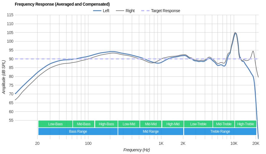

That Rting graph is compensated graph, and below is there raw uncompensated one. Which is the one you should compare with mine.
Here are two sets of measurements I've done for left and right. You can see the slight imbalance.
