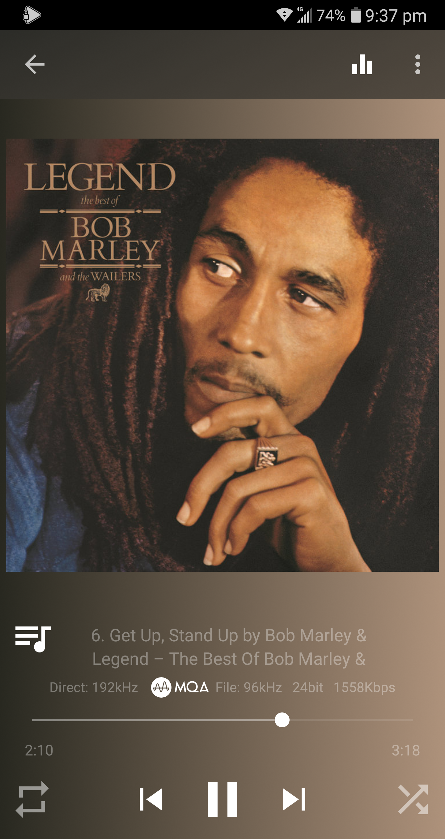

Looks fine to me. The original sample rate is 44.1kHz. Please also note that UAPP makes an educated guess to what sample rate the LG will be playing, since there is no way to query the actual sample rate after MQA decoding and rendering.
The actual mqa file is 24/96khz mqa unflod to 24/192khz
