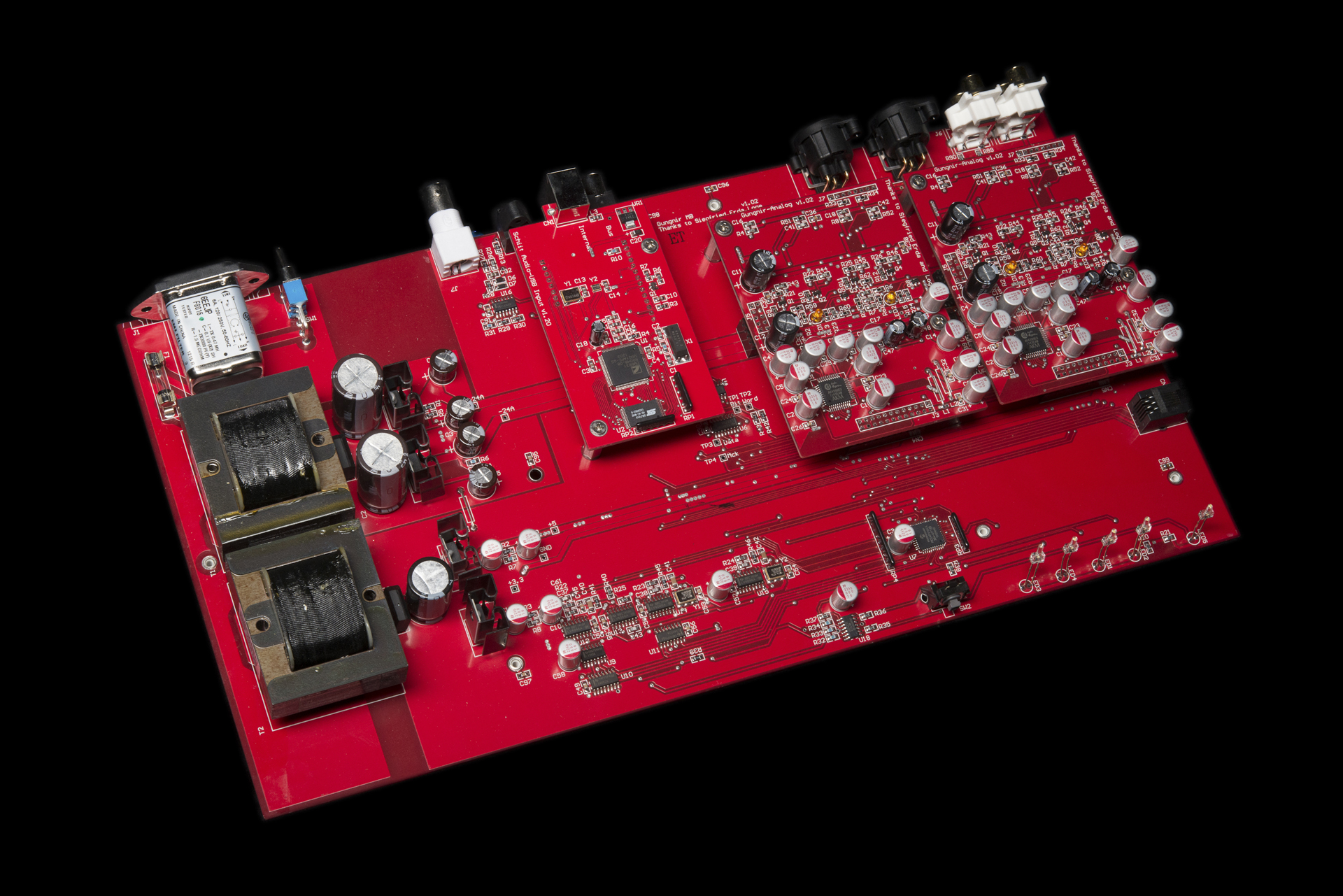

The firmware in question is just an 8-pin DIP PROM swap - which is a socketed IC on the DSP board (clearly visible in the pictures on Schiit's site).
So to the extent that you can read the contents of any PROM, everyone that has a unit has a "binary" of the firmware. What they don't have is a burnable source image. Though again, you could certainly create one from the raw PROM contents. But this isn't a case of Schiit sending out update files or anything like that (even if they did, you'd still have to pull the IC to do it, and have the requisite burner).
Oh, really? I assumed that's what the RJ45 jack is for, but maybe I'm wrong.
The Gungnir has a RJ45 jack, visible on the right side:
A picture from someone who modded their Yggdrasil suggests it has one, too, on the front panel board with the LEDs:
But maybe they serve different purposes.

That’d be for the control board firmware (input switching, phase inversion toggle, indicator control, muting relays). No idea if there have been changes to that, though if there have they shouldn’t have anything to do with the sound of the unit. If there have been updates there, I’m sure Schitt apply them on a factory upgrade.
The self-installed Analog 2 just included the PROM for the DSP board, which is fundamentally the filter code, and at a minimum would include the “glitch fix” which had already been slipstreamed into production units long before Analog 2 was available.
