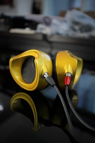

Wanted to share this, here's a one-off RR1 we made for a Customer through our Bespoke program.
