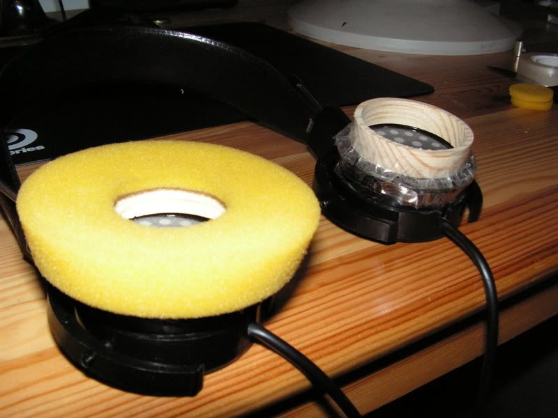

So, after getting some good tools the distancers are almost ready. Only need to get the pad-holder and the GS1K pads. I tested the 1cm ring on my MS-1 and must say I don't like it that much. Bass can be overpowering, especially on vocals. Overall sound seems a bit uncontrolled. I guess that is due to no velt in the inner ring.
But ofcourse, can't say anything about the MS1000. I just finished these 1cm rings, no velt, no GS1000 pads and no pad holders so my ears fall into the rings.
Just to let you guys know
EDIT: It reminds me of the HD595 a bit, but with more bass and overall less balanced.

Yes, only the half mod without GS1000 pads and felt coating can sound ugly.
Your distancer already looks quite good, but did you chose 1cm length instead of 1,3cm? I suggest your do another attempt with 1,3cm - you can glue something like a strong copper cable outside to achieve the bulge that will hold the pads.
Leave your MS1 stock until you have GS1000 pads and thin felt at hand.

Nah, I'm currently working on the ring to hold the pads. When I got two 5-6mm rings I glue them to the 1cm rings. Then I probably gonna grind them to 9mm rings and 4mm holders. I think 3mm pad holders is just a little too thin. FYI, the rings I already made are 3mm thick, which seems a bit too thin for holding pads.
Nick.
EDIt: PIC
You can see my padholders lying underneath my finished 1cm rings. There's still a lot of work to do and I could make it faster, but hey, I'm just a beginner and I also believe this is the first time I ever used a handdrill :P In the back you can see my new drillsaw, my dad bought. It was reallly expensive, the red one (40mm) was 14(!) euros and the white came in a box containing 20mm, 29mm, 35mm, 51mm and 68mm. The box was 29,95EU. But, I don't think my dad paid the full price, he had some discount I believe. Though very expensive, highly recommended.
If my distancers turn out good, I'm also willing to make some for other head-fi members. Though, the only paying I can receive is money via bank transfer.

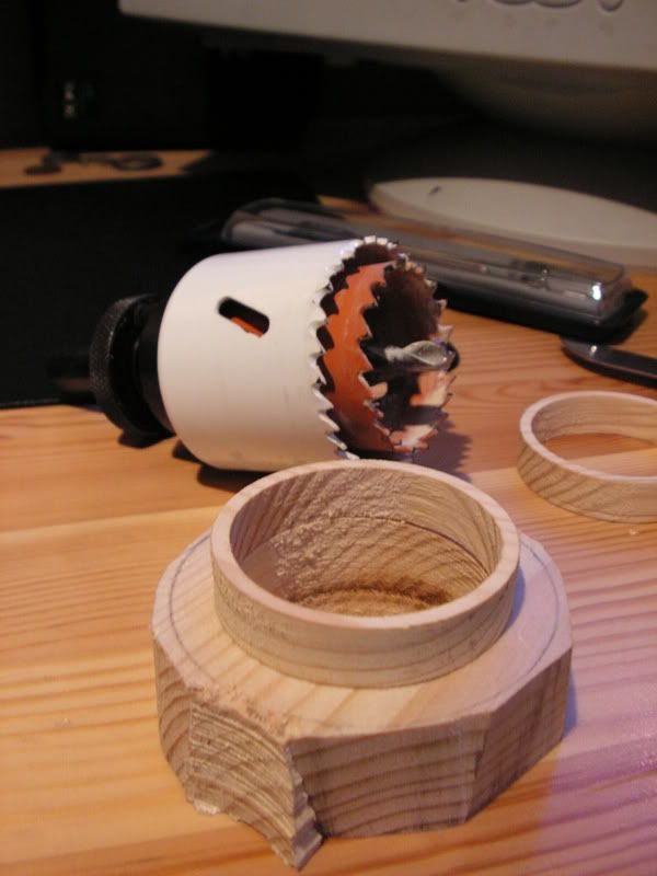

Nah, I'm currently working on the ring to hold the pads. ... I'm just a beginner and I also believe this is the first time I ever used a handdrill :P In the back you can see my new drillsaw, my dad bought. It was reallly expensive, the red one (40mm) was 14(!) euros and the white came in a box containing 20mm, 29mm, 35mm, 51mm and 68mm. The box was 29,95EU. But, I don't think my dad paid the full price, he had some discount I believe. Though very expensive, highly recommended.
Wow, that is a good tip for creating perfectly round wooden rings. This opens possibilities for making a complete headphone. Thanks for sharing and I am wondering if you got more of this kind of tips...
