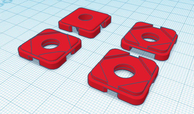

2 type of buttons :) Will print it/ After testing will sharing this buttons with all :)

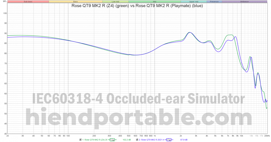

Continuing with the Z4 measurements, I have updated to the latest firmware posted here and I have connected it as a DAC to REW, to measure some of my IEMS. I have used balanced cable for all of them and the result is indistinct for the 2.5mm output and for the 4.4mm output.
Here you can see the influence of Zishan Z4 depending on the type of IEM connected. It is clear that it affects those with BA drivers much more, even though the impedance is not as high.
NiceHCK Lofty R (Z4) vs NiceHCK Lofty R (Playmate).pngIkko OH10 R (Z4) vs Ikko OH10 R (Playmate).pngRose QT9 MK2 R (Z4) vs Rose QT9 MK2 R (Playmate).pngShozy Neo BG R (Z4) vs Shozy Neo BG R (Playmate).png

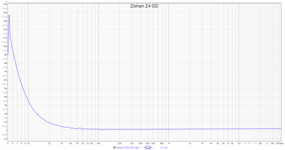

Zishan Z4 SE Output at vol 50 (DAC).pngZishan Z4 Distortion.pngZishan Z4 GD.pngZishan Z4 Impulse.png
The measurements have been taken with the line input of my PC, so don't expect them to be very reliable, except for the frequency response. That's why I don't go out of my way to use something like RMAA.
For the IEMS measurements I use an IEC60318 microphone connected to the microphone input of the Burson Audio Playmate I.

now the buttons are easy to press. I made it almost flush with the body (the leftmost model is closer to us).
  • zs4btn.zip
