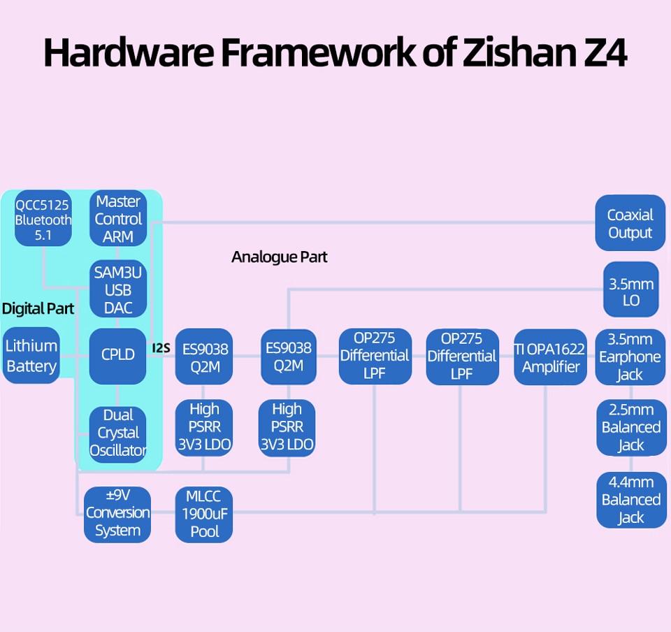

I saw in Z4 1 LPF opamp have R+/L+ and second one have R-/L- in balanced mode (4.4/2.5 and 3.5 is working as well we can listen music from 3 pairs of headphones (amplified) technically even from 4 (+1 line-out). In single ended, half of rail is working 1xDAC-LPF-AMP balanced outputs are off.
It should be different - like 2 audio rails (DAC-LPF-AMP) first +/- Right and second +/ Left?
