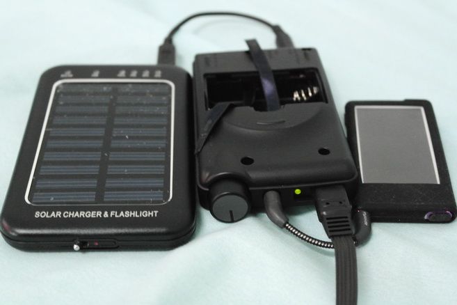

Anyway, here is a battery pack I just finish modding:
It powers up the SRM-002 without any problem. There is some hissing during startup but it usually will disappear within 5~10 seconds.

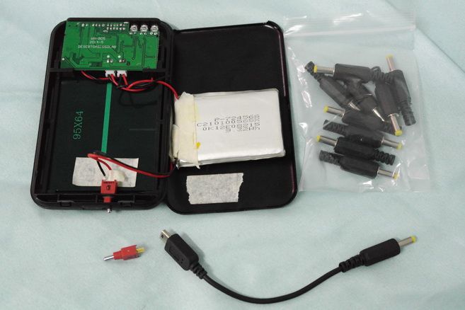

The battery pack itself is the only one I can find that offer a 4.5V output (measured to be around 4.6V) that is perfectly suitable for the SRM-002, plus it is cheap as dirt (usually under $20 on eBay, search for "4.5V solar USB"). The two downsides are (1) the stock battery isn't particularly big, only 2600mAH, and the case probably won't hold a much bigger battery. I thought I'll keep to the stock battery for now and look for a suitable upgrade later. (2) there is no on/off switch. I have to find the smallest toggle switch I can (element14 9473084), drill a hole on the side (as the top and bottom panel are metal), and superglued the switch in place, re-wire the battery so I can disconnect it from the PCB in order to prevent drainage all the time. Last but not least, I have to get the power connector from ebay (4.0mm OD x 1.7mm ID coaxial) and mod it onto an USB cable, which is relatively easy. The upside is that the solar panel will recharge the battery (or at least slowdown the drainage) during use. But it will have to be under pretty strong light condition.
Beside the occasional hissing during startup, the battery pack + SR-002 pretty much sounds like they are powered by wall adapter and definitely better than battery only mode. It is better than the KentLi batteries mentioned before but not quite as obvious as compared to NiMH.
