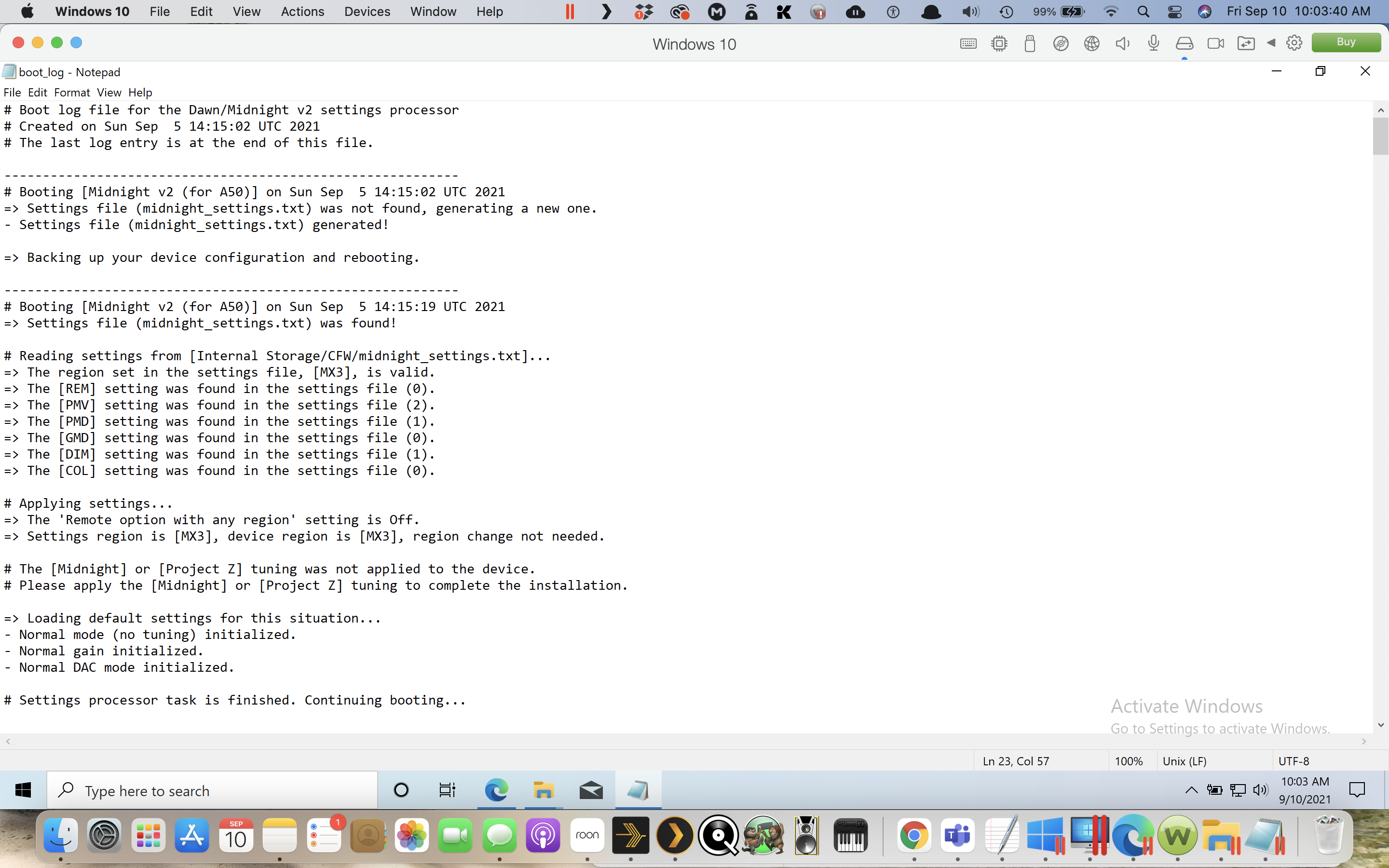

That's what I've been trying to do this whole time, make sure I correctly applied the external tuning (Project Z).
Sure thing, the first screenshot is from the beginning of the file and the second is from a few moments ago.

From the screenshot from a few moments ago, it looks like you applied an external tuning and all is fine (aka all your chosen settings are being applied accordingly).

Tuning was applied successfully. The log file lines continue each time you boot so you should only look at the most recent entry which will be at the bottom. Don’t worry about the earlier entries.
