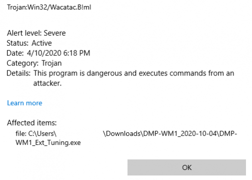

First time I get this warning.
All other files in the DMP-WM1_2020-10-04 zip file are OK.
It's the same Wacatac thing that was also being "detected" for some tuning mods.
I guess Windows Defender is really sensitive for an executable that contains another executable. I once sent a tuning mod to Microsoft. They said it's indeed not a virus, and recommended me to update the virus definitions or something, but for no effect.
Funnily, Kaspersky doesn't get it as a virus, for example. So nice try, Microsoft.
