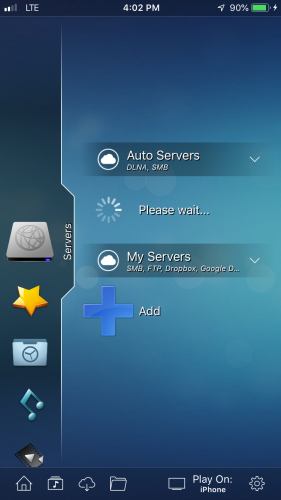

Need a bit of help again. Very curious as I'm getting these bumps after many months of superior performance with the Poly.
While on a flight today, my iPhone wouldn't fully connect my Poly using Gofigure. Gofigure would show a connection. I then connected my Poly as WiFi under the iPhone settings (as I'm using hotspot mode) and tried to play music with mconnect and then 8Player. Neither would show the Poly as a source. At one point I was able to connect the Poly to access music stored on my mSD card, but only by using the earphone jack of my iPhone. That didn't last too long once I tried to use something other than AirPlay. I was not able to repeat that again using AirPlay.
After a few repeated attempts, I did a factory reset. Still no good. Once the plane landed and I got to the hotel, I wiped and reinstalled Gofigure and did another factory reset. And yet no progress. What to do?

Matt,
I was reluctant to use the factory reset, but I had few options after spending a good hour with various attempts and reboots. In the end, I felt that I had nothing to lose and performed the factory reset.
In all of my attempts, I was using the Poly hotspot mode and not my iPhone's personal hotspot. After the factory reset, I did not initially reset the PIN for the Poly Bluetooth. Since your message, I selected "forget this device" for the Poly on my iPhone's Bluetooth settings. After doing that (and rebooting the Poly and the iPhone), I am still unable to connect to either 8Player or mconnect.
I attached a few screenshots for your review to see if I am missing anything obvious. Note that on the 8Player screenshots, I am unable to select the Poly under "Play On:" in the lower right.
David
