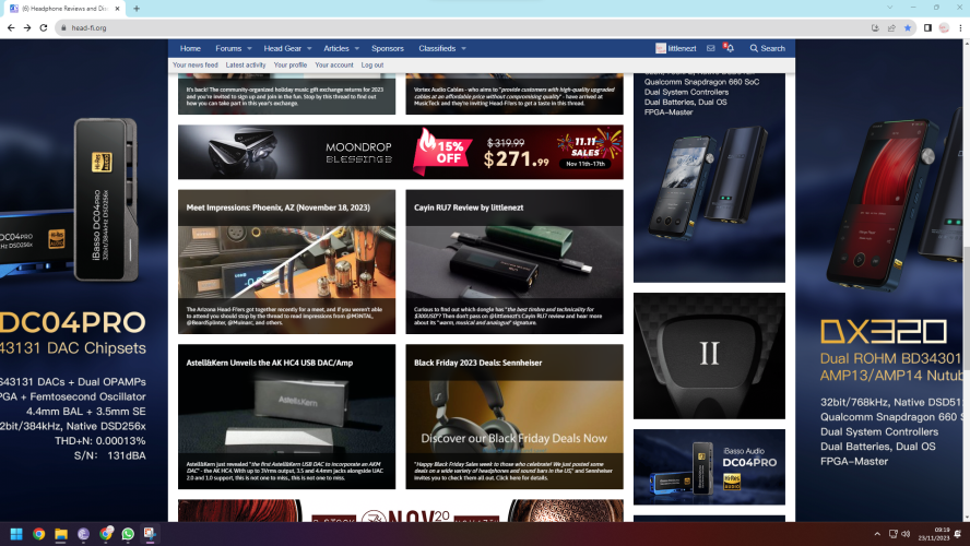

Just in case you guys want to read my "don't shake the dongle" :wink: review that got featured recently on the main page of Head-Fi
you can read it here : https://www.head-fi.org/showcase/cayin-ru7.26493/reviews#review-32067
