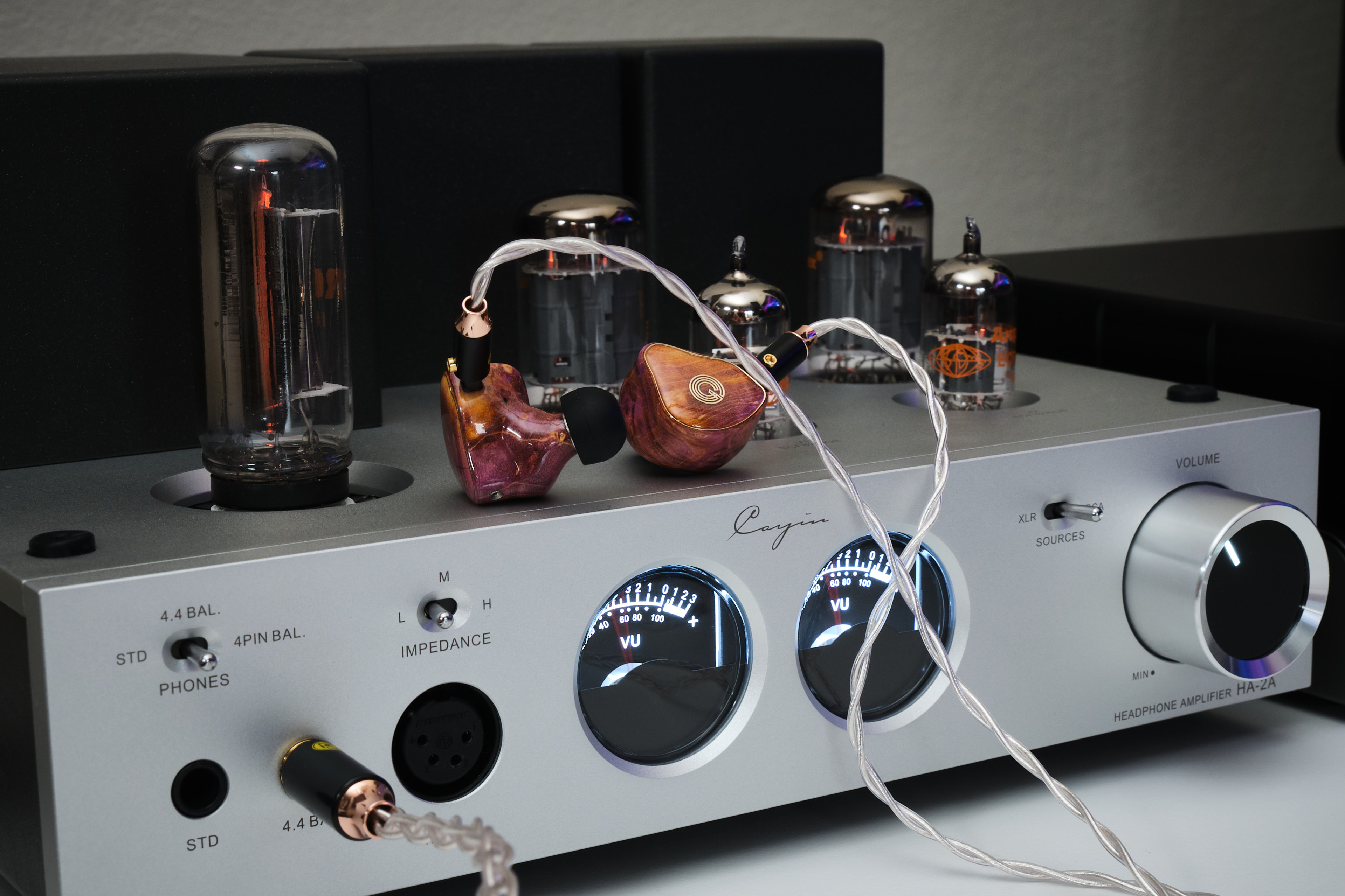

Cayin HA-2A Vacuum Tube Headphone Amplifier
The HA-2A is an entry-level product in the HA series of headphone products, enriching and complementing the HA series product lineup. This will be an upward replacement of our HA-1Amk2. While fairly low-cost and compact, we don’t take this lightly. The HA-2A is a pure Class A transformer-coupled Single-Ended design, which is probably the best direction for tube amplifier with decent versatility and practicality for audiophile applications.
The HA-2A uses a total of five antique-grade NOS imported vacuum tubes.
  • Driver Tube: Amperex ECF82/6U8 NOS tubes
  • Output Tube: matched pair of Amperex 17BF11 NOS tubes
  • Rectifier Tube: 1 piece of RCA 17AX4GT NOS tube (for driver stage)
Amperex ECF82/6U8 NOS tube: This is a composite tube that combines a pentode and a triode, used for frequency modulation and mixer in early electronic tube televisions. It has low noise, low internal resistance, balanced sound in the entire audible frequency range, rich harmonics, and a vintage tube's unique mellow and warm characteristics when playing music.
Amperex 17BF11 NOS tube: This is a composite tube that combines two pentodes, one for power amplification and one for voltage amplification. This tube is frequently found in early electronic tube televisions. It has a balanced, full-bodied sound, good control, and the vintage tube's characteristic mellow and charm when playing music, able to accommodate a variety of music styles.
RCA 17AX4GT NOS tube: This is a half-wave rectifier tube responsible for supplying screen power to the front-stage electronic tubes. It fully embodies the unique characteristics of the harmonic richness and delicate warmth of the rectifier tube.
Other Features and Design Considerations
  1. The output from Amperex 17BF11 will feed into a pair of custom design in-house manufactured high-quality output transformers for single-ended (6.35mm) or balanced (4-pins XLR and 4.4mm) headphone output.
  2. Support Balanced (XLR) and single-ended (RCA) input, balanced input will transform to single-ended through a pair of input transformers.
  3. Choice of three impedance-matched headphone outputs (L, M, and H) to make sure HA-2A can handle a vast variety of headphones satisfactorily.
  4. The electronic tube amplification circuit adopts point-to-point soldering technology, reducing the interference between components and circuits.
  5. Features a white backlight dynamic dual-channel VU power meter.
Last but not least, the HA-2A shared the same footprint as our iDAP-8 Streamer, iDAC-8 DAC, and iHA-8 Headphone amplifier, which means you can stack them up as a compact and yet sophisticated Desk-Fi system that occupied less than an A4 sheet.
The HA-2A will debut at the 2023 China Guangzhou International Headphone Expo (16-17 December 2023). We shall provide more information about the HA-2A after the Guangzhou event.

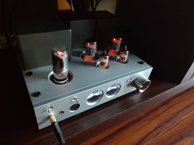

Looks like a HA-3A, but I assume a bit smaller in size?
Yes, HA-2A is smaller in all three dimensions. The HA-3A is 306mm wide, and the engineering prototype of HA-2A is 270mm.
Sorry for the rough picture, I take this snapshot when we are packing up the booth at the end of the Guangzhou headphone show.
