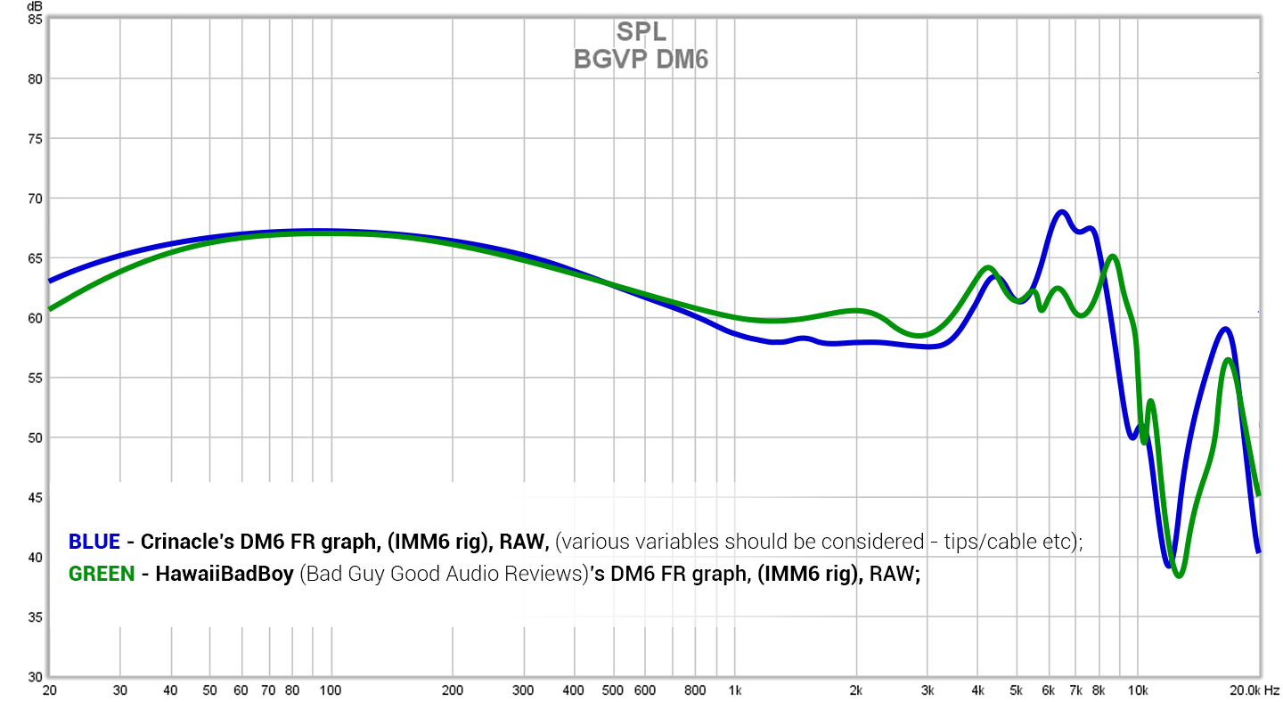

Jan 25, 2019 at 1:22 PM Post #1,938 of 5,354
@perfecious sorry but i think you are making too much of a jump in your conclusion with what little you have to go by.
There are too many factors that create variances which your conclusion can not take account of.
You must be careful not to accidentally start scare mongering based on very little satisfactory evidence.
Jan 25, 2019 at 1:27 PM Post #1,939 of 5,354

I don't think what I have is "little". What we have here, is two different guys, using the same rig, with the same IEM, having very different experiences
they also do have slightly different setups and possibly more importantly, different ears and different tastes.
Jan 25, 2019 at 2:47 PM Post #1,942 of 5,354
@perfecious that’s why I said “accidentally”.
Some might read your interpretation as gospel without much tech understandings themselves.
I believe it can be very damaging to insinuate a manufacture may be responsible for driver variance due to QC etc . I noticed you highlighted in cable later.
I don’t think the two graphs alone from none scientific lab environment (HBB I believe has just has started out with his rig) are enough to make such a statement that could have very damaging affect to manufacturer.
More caution is required when making such strong statements imo.
@Redcarmoose I just listened to that track on Tidal (16/44) and did not pickup right channel distortion (LGV30-3.5mm NB).
I can try again with 24/192 if you can give the exact timing of that noise you hear.

I don't think what I have is "little". What we have here, is two different guys, using the same rig, with the same IEM, having very different experiences, which is the same as you or me getting the "Crinacle experience", while HBB has the great experience, which can cause actuall problems and even distrust. That's what the community should be careful about IMHO.
Also, tube length and tip-difference won't create these huge "phase shifts", that we all see on the graphs. Which again - my "non-definitive" conclusion would be - the cable. And I'm trying to do the exact opposite of "scare mongering". I want people to try the DM6 with different cables at least, which I'm 98% sure is where the differences come from, before they jump off and sell their DM6, which it would appear to be severely affected by the crappy SPC (gray mixed) cable. That's all I wanted from the very beginning. I'm actually considering sending my SPC cable (if I get it with my DM6) to HBB, so that he can test his DM6 with it. His stock cable was actually the white one, which many people said it was better, so even If he measures it (as some people have requested), it will not be very telling. I'm actually curious what cable Crin had when he measured the DM6 (if he can remember), but... anyway.
That's it. Now I'm going to sleep, because I'm almost dead from exhaustion. :)
I like how much effort and thought you are putting into this, however you can´t "rescale" the graps and compare them one to another like this.
As much as I would like it to work like that, it just doesn´t. Measurements are much more complicated and, as you know, every fraction of the milimetre and not only that can make a noticeable difference.
For demonstration, let me quote my old post with my measurement. I was using random cheap uncalibrated mic in vinyl tubing, however I´m not that far from the "correct" curve. At the end I don´t care, as I use the rig just for relative comparison and possibly channel matching :)
Today I was playing with some filters for DM6. Settled on a rolled piece of alcohol swab in the nozzle for now.
Uncalibrated masurements included, to my surprise they are pretty close to ones from crinacle..
red - stock, light blue - with filter
Customizing treble is really simple with these alcohol swabs, just try different lengths and see which suits you the best.
I used a strip which is slightly longer than 3,5mm jack as you can see in the picture above (lazy to measure its length).
Treble is now cleaner and less distracting, however I see how someone would prefer stock treble, but I´m kinda treble sensitive.
comparison with T2 if anyone is interested..
