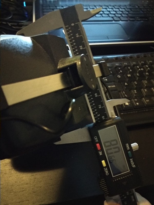

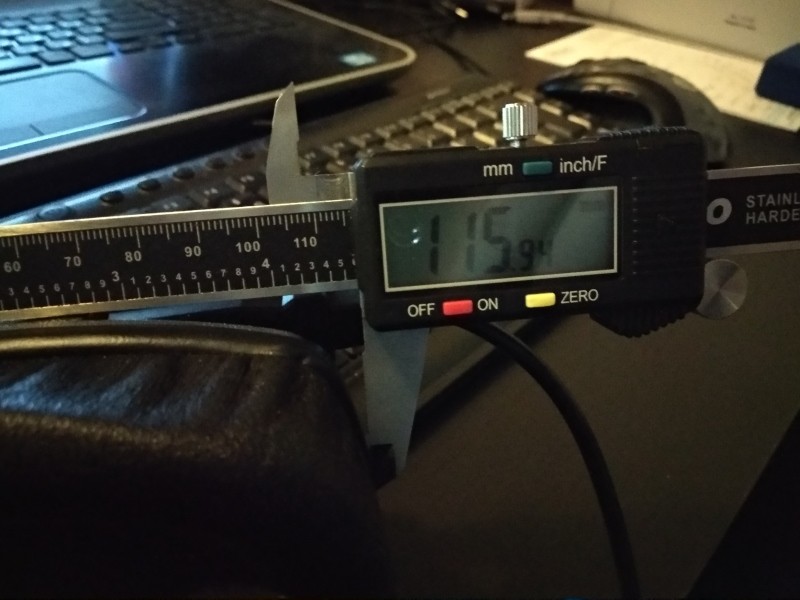

Can anyone give me the dimensions of the stock DT150 earpad? They look similar in shape to the huge Koss ESP pads, but are much cheaper (but might be smaller).
Thanks!
Thanks!
Here we go (in mm):
However I would strongly recommend AGAINST changing stock pads if you care about the sound quality of these wonderful headphones. Been there, heard there.

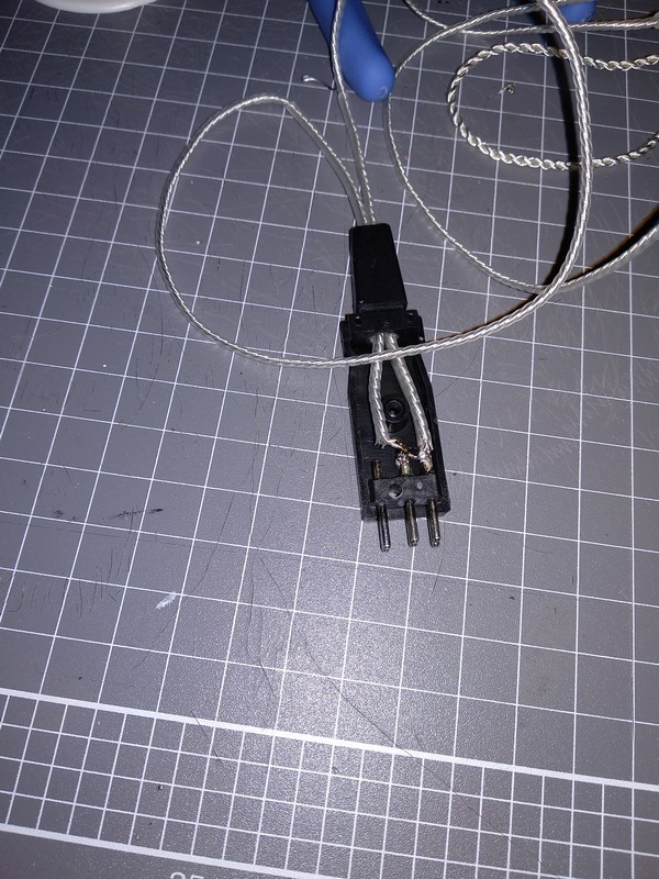

DT150 is truly a gem. I've had them for years now and not planning to get apart. They also can be converted to balanced headphones by DIYing a new cable and this is what I'm working on at the moment. I've done a few cable projects in the past but this one is to have them terminated with TRRS 2.5mm balanced connector. If successful will share an update as I always do.
I was sucessful in recabling, so here I come:
$7 cable from ali:
A little bit of soldering:
Final result:
Works wonders!
Pinout for TRRS connector
(cable side)~== L- === L+ === R+ === R- ==> (connector tip)
Pinout for DT150 connector
Get the connector and turn with pins protruding towards yourself:
L+ R+
L- R-
o o
The bottom ones are not used.
