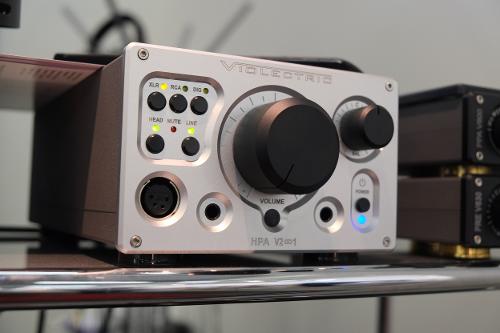

A few photos from the Munich High End Show 2014:

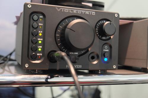

Black front
Black V220

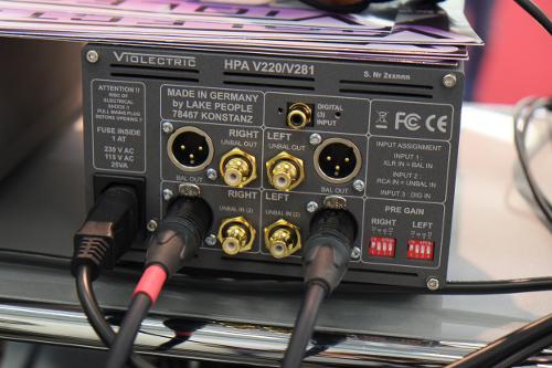

back

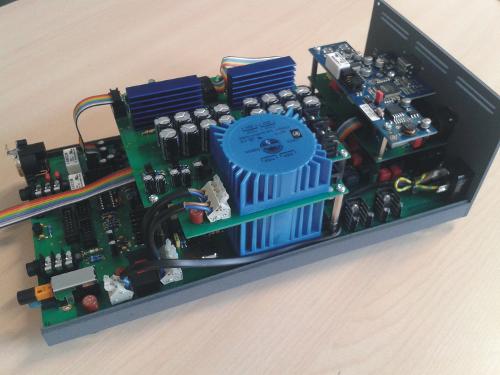

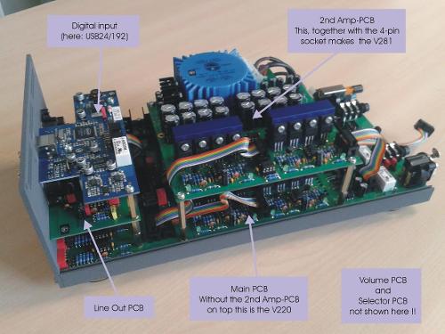

A few pictures of the internals:
