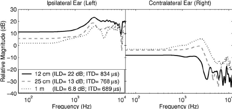

Spatial deafness and the limits of real life ILD.
I think headphone listening without crossfeed causes people spatial deafness. Just like after driving fast for a while slower speeds may appear very slow, exposing your ears to excessive spatial information with headphones may cause spatial deafness. Because of this turning crossfeed on may cause a feeling of quite monophonic sounds which causes negative reactions on some people, but those people make their judgement too fast. Listening to crossfed sounds for a while causes the effect of spatial deafness to go away and the spatiality of the recording "emerges" from the monophony. Crossfeed tends to show it's benefits lowly. Hearing adjusts lowly tp the lack of excessive spatial information and the unnatural "special spatial effects". The lack of listening fatique happens after a longer listening session. However, after the benefits of crossfeed have become clear, one doesn't want to go back to the unnatural supersterophonic listening.
Our hearing is very sensitive for ILD and ITD -information. At low frequencies no more than about 3 dB of ILD is needed. That is almost monophonic, but our spatial hearing is that sensitive and of course combined with supportive and actually more important (under 800 Hz) ITD -information it is enough. Listening to loudspeakers doesn't produce ILD greater that this. Depending on the room modes and revereberation the ILD with loudspeakers vary between 0 and 3 dB at low frequences. This can be seen on HRTF-measurement, were the difference of +90° and -90° horizontal angles at low frequences is about 5 desibels for a sound 1 m (40") away and even less for sounds of greater distance [1]:
We also see that for sounds only 12 cm (5") away max ILD at low frequencies is almost 20 dB! That is why headphone without crossfeed sound so close and small and why the soundstage gets bigger with crossfeed, which to many may find counterintuitive. Narrowing stereo separation actually widens the sound to a certain point after which the sounds becomes so monophonic that the soundstage collapses again. Having the optimum amount of ILD is the key! For typical speaker angles HRTF-responses look like this [2]:
Here LL is left speaker for left ear and LR left speaker for right ear. Here ILD up to 200 Hz is 0 dB! However, this is misleading, because the room reverberation (modes) will produce some ILD so that the final ILD is between 0 and about 3 dB. Totally monophonic bass isn't best with headphones. In my opinion a few decibels of ILD create a natural sensation of low frequences behaving according to the laws of physics in an acoustic environment. The important point to undertand here is that with speakers it doesn't matter whether you have 0 dB or 100 dB channel separation at bass, because room acoustics + HRTF transforms it to 0-3 dB for the listener depending on the frequency anyway, but with headphones (without crossfeed) it means the difference of "life and death", so wouldn't it be rational to optimize ILD at bass for headphones? That means limiting it to about 3 dB.
Dec 2, 2017 at 11:21 AM Post #235 of 2,192
This is likely true, but a temporary condition. Making up a new term like "spatial deafness" is alarmist. It already has a name: Auditory Adaptation.
Personally, having tried listening with various types of crossfeed, and for extended periods, my personal experience is that only very few recordings sound better that way, and going back to no crossfeed on a recording that doesn't benefit from it is always an improvement, regardless of time spent listening, though eventually whatever I'm listening to becomes natural because of Auditory Adaptation.
Kind of underestimating room modes here. If they combine to create a null, a very slight difference in position makes a very big difference, much bigger than 3dB. If you're sitting in a null, ear spacing can be enough to do this. Deep nulls occur in rooms all the time, relating to frequency and dimension.
Except...you've ignored how recordings are made and mixed. A hard-panned, acoustically or electronically "dry" sound is indeed very rare, sort of an "effect" rather than a normal mix technique. As soon as you put ambience around the sound and in the opposite channel that close perspective is mitigated.
I strongly disagree, and anyone experimenting with this will readily see that narrowing separation by simply mixing both channels NEVER results in widening of the soundstage. If you want to widen by reducing separation something else must happen too!
Here LL is left speaker for left ear and LR left speaker for right ear. Here ILD up to 200 Hz is 0 dB! However, this is misleading, because the room reverberation (modes) will produce some ILD so that the final ILD is between 0 and about 3 dB. 1. Totally monophonic bass isn't best with headphones. 2. In my opinion a few decibels of ILD create a natural sensation of low frequences behaving according to the laws of physics in an acoustic environment. 3. The important point to undertand here is that with speakers it doesn't matter whether you have 0 dB or 100 dB channel separation at bass, because room acoustics + HRTF transforms it to 0-3 dB for the listener depending on the frequency anyway, but with headphones (without crossfeed) it means the difference of "life and death", so wouldn't it be rational to optimize ILD at bass for headphones? That means limiting it to about 3 dB.
1. Mono bass results in far stronger bass response, though. When bass arrives in both ears it becomes stronger, more solid, and more purposeful. Listen to a strong bass line then cut one ear, you'll easily see the effect.
2. The acoustic environmental effects are far stronger that 3dB, though. And frequency dependant. This cannot be simply simulated with 3dB of bass crossfeed.
3. Oh yes, it DOES matter! Bass in rooms is a result of what happens in ALL speakers and the resulting room mode stimulation. The best example of this is the theory of multiple subwoofers.

[1] Spatial deafness is simply a subgenre of Auditory Adaptation.
[2] I really don't get this. To me recordings that work best without crossfeed are few and far between.
[3] I don't underestimate room modes! I have done research work how to pre-filter signal before it's fed to the speakers to reduce room modes. In pathological cases I suppose it's possible to have ILD bigger than 3 dB, at a certain frequency and place in the room and at reduced SPL level masked by other frequencies.
[4] Wasn't rare at all in 1958! Even the newest compressed "headphone-friendly" pop has ILD > 3 dB bass.
[5] You are clearly a person, who knows a lot and has done a lot for decades, but for some reason you have these strange fights against me. The science is behind me. Larger ILD means the sound source is close to the other ear. It's not only self-evident, but measured HRTFs show it clearly. I really don't know what's wrong with you. :rolling_eyes:
[6]
1. Yes. However, a few decibels of ILD sounds more lively imo so I don't always go for mono bass.
2. Room modes create typically 10-15 dB peaks and even deeper dimples. However, most of the time this doesn't affect much ILD and if it does, at low level, masked and possibly below the hearing threshold anyway. Usually the modes become dense enough to transform into reverberation below 200 Hz where the wavelength is about 2 m. You are splitting hairs. Yes, what I said doesn't work in every possible pathological situation, but in general it does and those pathological situations are called "very bad acoustics." People tend to fix them, at least those who care about fidelity. Often all it takes is to move your speakers or chair a feet to make a diffence.
3. Yes, when we talk about the quality of bass. I was talking about ILD only. The quality aspect does indeed support monophonic or near-monophonic bass. Reducing the ILD at bass in a recording say from 10 dB to 3 dB is a big step toward that.
