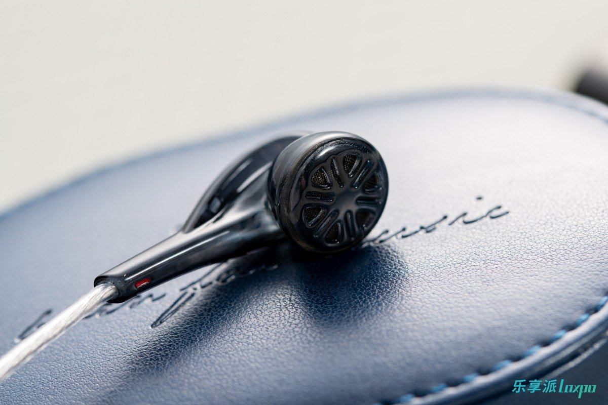

1. Why Did We Design Such a Unique Look for the EM5
The EM5 project was actually established in 2017. At the beginning, we wanted to copy the most fashionable double flute design at that time. Those who are familiar with that era may know the classic one like the V99. We even went to find some old earbuds to explain to our young engineers what a flute (bass sound tube) is and what its structure is.
However, during the design process, we found that even the materials, design tools, and production processes have been improved. Today, it is impossible to go beyond the traditional open earbuds. So what left to us was either to directly copy the design, or to find out a different way. Therefore, the progress of the open earbuds project has moved terribly slowly.
During this period, FiiO also began to introduce 3D printing technology to mass-produced models. From the FA7-FA1-FA9, by cooperating with HEYGEARS and the manufacturer we have overcome many obstacles which also helped us know more about the application of 3D printing technology. On this basis, the idea of using 3D printing to make the open earbuds came to us. After carefully figuring it out, we assumed it might have many benefits.
1) The 3D printing can achieve seamless processing workmanship. Compared with the conventional gluing workmanship, the 3D printing is obviously more advanced on the fineness. And the high-end resin materials used in 3D printing have amber-like texture, making the shell of the open earbuds look fantastic.
2) The structure of the traditional sound tube is complicated. Besides, it might lower the audio quality as a result of easily leaking air. What's more troublesome is, such as some classic tube models, the volume of the whole earphone would be relatively larger to ensure the length and caliber of the tube.
3) Controllable integrated cost. If we decided to copy the classic, a lot of molds would be needed. In this way, the research and development cost would be extremely high despite the low manufacturing cost of mass production. For models like the EM5 that are unlikely to be mass-produced, although the 3D printing processing and manufacturing cost of a pair of shells is high, the overall cost of choosing 3D printing (included the mold cost) will be more friendly.
Considering the above factors, the ID designer put forward a bold design according to our requirements (acoustic flute design), and deliberately isolated the sound tube as an interesting design visually. Some people think of this ID design as an alien, while some say it looks like a snake, a dragon, and even a predator. However, one thing everyone agrees with is that this ID is a bit wild, bold and unrestrained, completely out of the traditional frame of the open earbuds.
To be honest, FiiO's styling has always been stable for considerations of many commercial factors as well as user preferences. Therefore, it is unavoidable to be led by users, which contributes to rather reserved and stable ID designs.
In conclusion, the ID design has actually taken most time in the three-year process of the EM5. In order to create something new, we finally reappeared the classic acoustic flute design 30 years ago in a different way by virtue of the newest 3D printing technology in the 21 century. A collision of tradition and modern gave a personalized exterior style to the EM5. In fact, according to the feedback from netizens we have contacted in the past two days, those who like it like it so much while those dislike it just dislike it. But this is not important, for the EM5 itself is not focusing on the mass market.

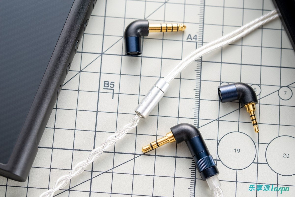

3. Why Not an Interchangeable Cable Design?
Back in the day, if the open earbuds are equipped with an oxygen-free cable, it would be regarded as incredible earbuds. Unlike now, there are so many choices for cables of various materials and structures. Therefore, most of the earbuds facing the HIFI market now adopt a replaceable cable design to meet the needs of users to "burn" cables.
However, due to the limitation of its structure, open earbuds rarely use a cable with the replaceable 2PIN/MMCX connector. If you are interested, you can take a look at a few of the designs with replaceable connectors, either of which is with a thick handle or a large and raised cavity.
So at the beginning, we have thought about referring to the structural design of the Sennheiser IE800 with which one part is fixed while the other is replaceable. Although it is impossible to replace the entire cable, it still has the playability to change different cables of different materials. It is also convenient to replace different connectors of 3.5/2.5/4.4 and so on.
Later in the tuning process, our tuner had tried a variety of different materials of cables, and found that the best sound comes with a sterling silver cable. He suggested to not change cables on our own. Considering that the EM5 is not a market-oriented model, we decided to respect the tuner's opinion. As for uses' needs to match the front end of different connectors, we figured out the replaceable plug design.
Therefore, if you are really entangled in burning the cable, we are sorry to say we fail to help.

2) How much is the monocrystalline silver cable? For some reason, we will not promote any of the cable purity officially. The included cable of the EM5 is a 4N monocrystalline silver cable plus the standard 2.5/3.5/4.4 replaceable connector design. If we sell this cable alone, the price of it will be set to over 160 USD.
