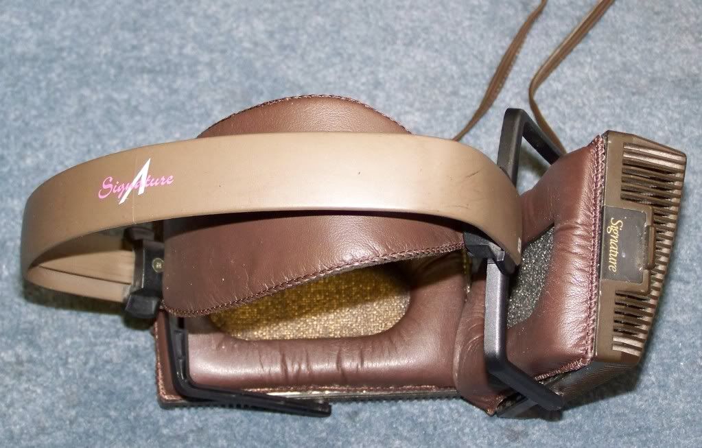

THe driver is gold, like the one shown above by Gilency. The only difference I can see is a small red mark about 3/8 inches wide, across the gold frame at the bottom, just where the terminals are. I assume this is to mark polarity.
Feb 26, 2010 at 10:44 PM Post #21 of 162
Originally Posted by spritzer /img/forum/go_quote.gif
That's the older Lambda Signature chassis and what I can make out from this picture, the drivers are stock as well. Cable too.
Birgir, didn't the Lambda Signature have the old type of forks (ala the Lambda Pro or the original Sigma?)
My LNS has "Signature" in red on the top of the driver cases. I think it also had "Stax Lambda Nova" in red on the top of the headband also. The reason for the "I think" is that the arc assembly snapped and I replaced it. Can't remember if it was exactly as per the original, but everything else is stock standard and was bought new. I have a Lambda Nova Classic arc assembly also as a spare - it has Stax Lambda Nova in light fuschia written on top of it, compared with the red of the LNS.
In summary, Ed appears to have an interesting combination.
1. The driver cases may be for a Signature (Signature in gold as per Plaidplatypus picture)
2. The arc assembly and forks from a 404
3. The driver is a LNS driver as it is gold
4. The Signature cases would have to be drilled out a little to engage the larger nubbin on the end of the forks of a LNS or 404 arc assembly - as per the work required on Ed's Sigma/404, which needed a new arc assembly and forks as well (mine didn't need a new arc assembly and forks, so they are the originals)
5. Can't really tell what cable is present there. Is it the same as the Sigma/404, 404 and the 007A? That is what was used on the LNS.
Feb 27, 2010 at 2:55 AM Post #23 of 162
I thought the Signature had the same style headband as the SR-Lambda, SR-Lambda Professional, and SR-Sigma Professional.
Feb 27, 2010 at 4:53 PM Post #26 of 162
The Lambda Signature did use the old arc assembly but I'm guessing the one on Ed's set broke so Stax replaced it with the current Signature replacement i.e. the SR-404 arc. The rest of the phones looks to be stock, narrow PC-OCC cable (notice that the conductors are close together and not spaced apart) and the Signature driver is gold like that since it is made with solid brass stators.
To use the new arcs on old phones you just have to remove the metal inserts into the earcup and they work well. Not easy to remove them though...
