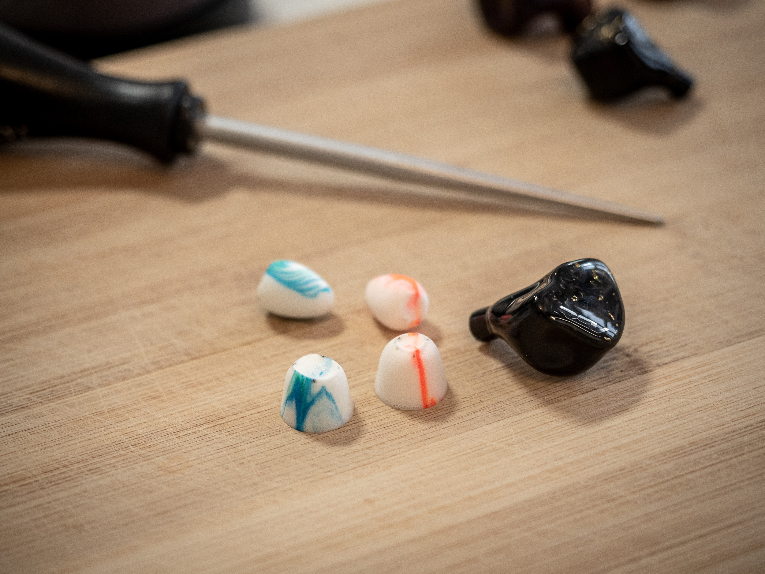

Small picture tutorial for custom foams. I needed replacements and thought I'd document it along the way.
I am using Moldex 7800 Spark Plugs. These are extremely soft. Stiffer foams are easier to work with. But I'd claim these are even more comfortable than actual CIEM.
You don't want to use the full length of the foams. I used a pen to mark 1cm length around the Spark Plugs.
You will notice the plugs deform quickly before you actually manage to cut them. On the image you can still see my 4 pen marks. I hit the target quite well.
For me it worked to apply the knife in stages between two marks. Make sure your knife is really sharp!
After the cut, you will need to give the foam a few minutes to extend back in its original form. Time for a coffee...

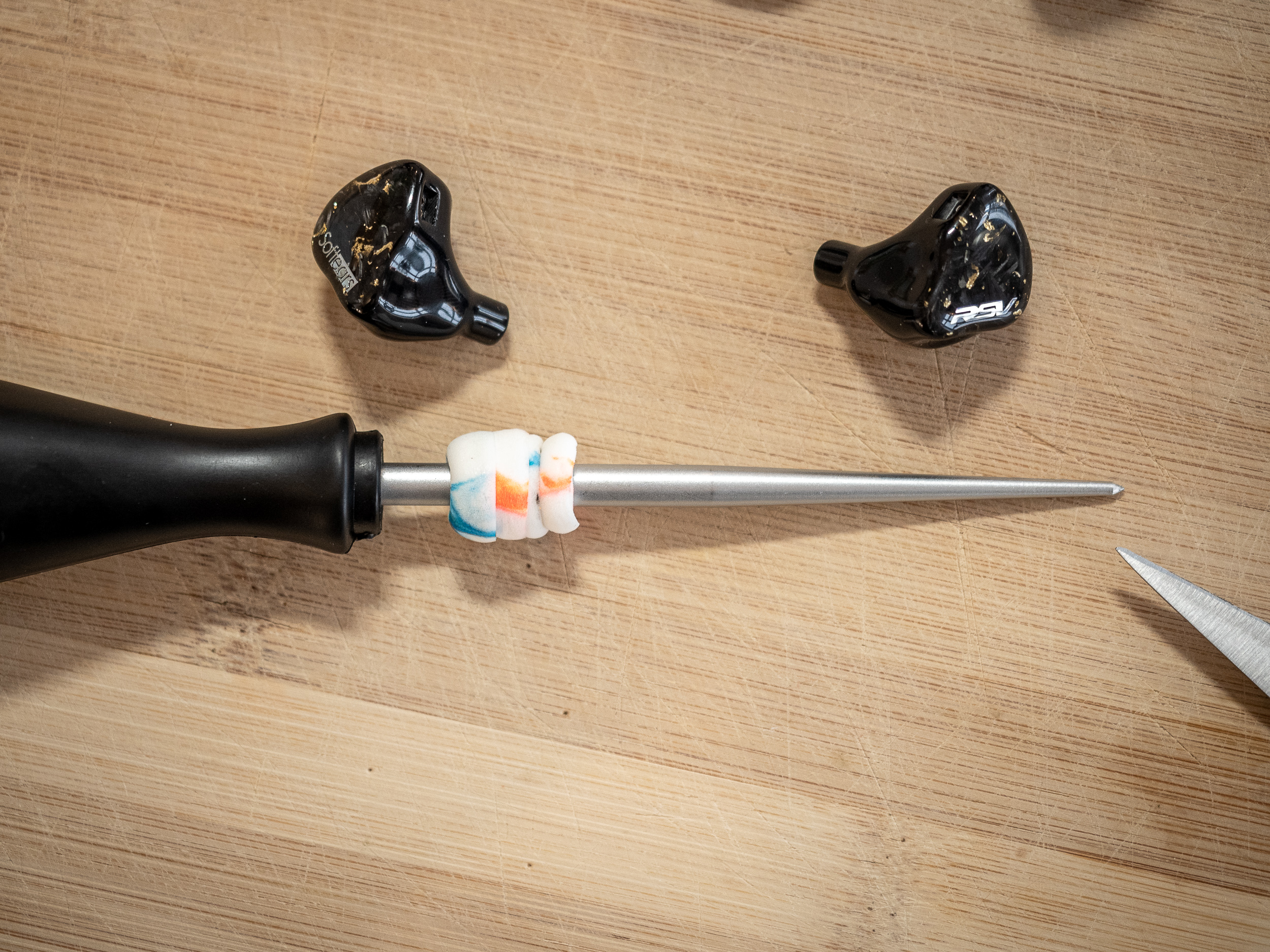

Now it's time to punch a hole for the nozzle. You might want to use a hole puncher instead of a bodkin if you use foam that's not quite as soft. But for the 7800 I found the grip to be better with just a tiny hole. You should do more sets while you're at it.
If you use a hole puncher, be careful not to punch a hole that is too wide. 2mm is probably the maximum unless you want to slide the foam under a silicone tip. In that case you might have to experiment a bit.
Stretch the foamies over the nozzle. Enjoy another coffee.
Finally, done. Enjoy superb comfort, a more flush fit and excellent isolation. Driver flex is gone too (not an issue with BA anyway). Isolating foams have much smaller and tighter pores, thus you won't lose bass impact as with Comply tips.
The RSV is one design where the custom foams are excellent and even a must-try! But it also works quite well with similar designs. The custom foams usually allow a deeper insertion and also open up the treble. This might not always sound better. But from my experience, the result is pretty good with universals that are also available as a custom in the same design. The sound should be shockingly close to the actual CIEM.
