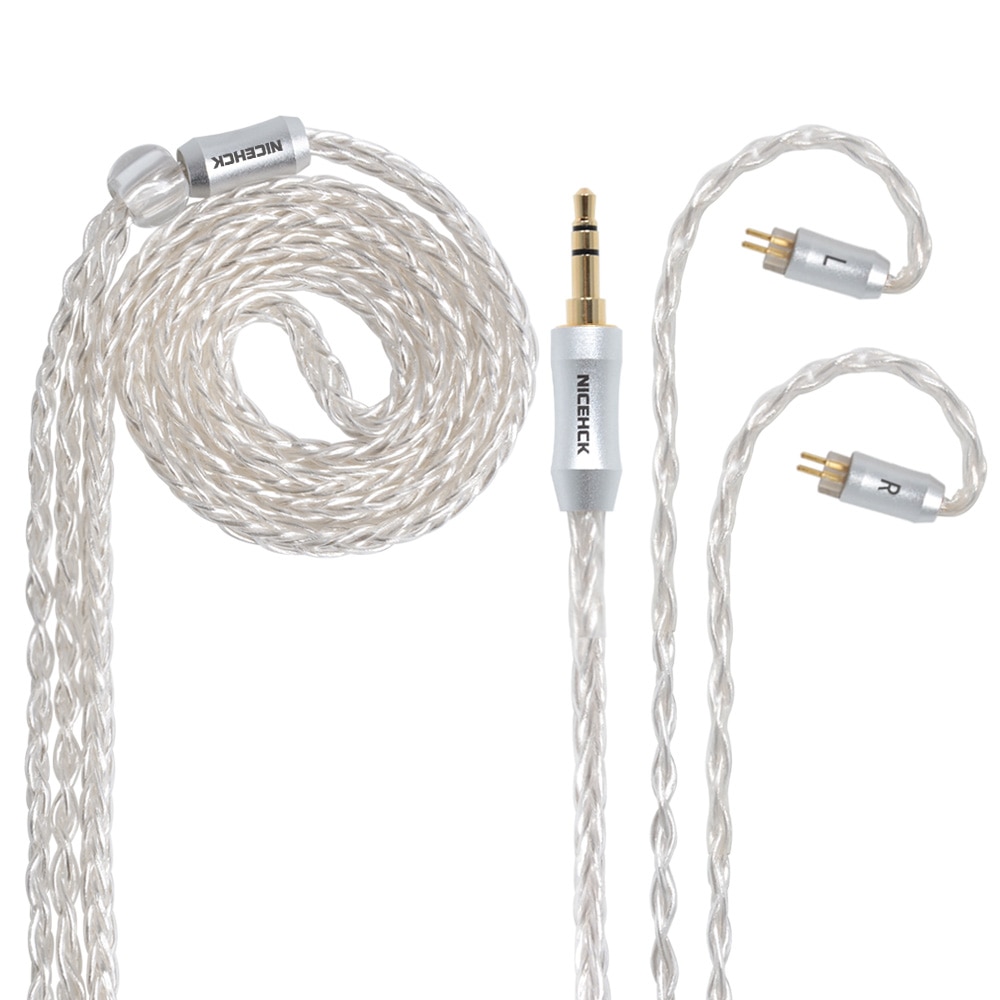

So I've been procrastinating at getting some MMCX cables and I'm now looking at these two options (thanks to HungryPanda and hakuzen for recommending):
https://www.aliexpress.com/item/NIC...4mm-Plug-MMCX-2Pin-Connector/32953432742.html
https://www.aliexpress.com/item/NIC...3-5-2-5-4-4mm-Plug-MMCX-2Pin/32954926911.html
Noob question - what's the difference between silver plated and high purity copper? Is there a better option at this price point or should I wait for the next batch of AliExpress sales in March for more options?
based on my experience with chi-cables:
copper
when they say high purity copper, it means simple OFC (oxygen free copper).
there is better quality copper (single crystal, OCC -Ohno Continuous Casting-, and variants, like frozen copper or others). in theory, few boundaries in copper help to better conductivity, more linear resistance.
same with purity grade of copper (4N=99.99%, 5N=99.999%, 6N=99.9999%, 7N=99.99999%). fewer impurities help to better conductivity, more linear resistance.
if the changes when using this better copper are audible, is still in discussion. measurements say the difference is not audible. but there might be some differences (minor distortions, for example) which can't be measured, and our brain is very special when perceiving sound.
anyway, difference of price is usually huge, compared to audible improvement. chinese manufacturers and sellers lie frequently about the quality of the copper (specially about purity grade) and it's difficult to prove it.
so trying them is the only way to know if it's worth it for you.
silver plated copper
when they say silver plated copper, it is usually tin plated. when they say pure silver wire, it is pure silver plated copper wire frequently.
true silver plating raise the price considerably. and true pure silver wire is around double the price of true silver plated copper.
silver is only a bit more conductive than copper. its structure and purity could contribute to better conductivity, more linear resistance, as well.
again, we are in the same place than before: audible improvement? at what cost?
there is some consensus about copper and silver (true silver, not tin or other alloys): copper preserves lows better, silver preserves highs better. not demonstrated once again, but some people affirm to be able to distinguish between them.

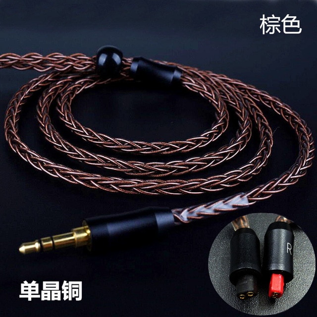

053. great conductivity. some details (strain reliefs, easier repairable plugs) are better in (052). this wire is thicker, softer but less flexible. weight: 27.2g. variants: copper/ mixed copper & silver plated / silver plated (various colors, worse conductivity though).
structure could be: 0.10mm*19(25awg)*8c [2c/signal:22.5AWG]. if true, and wire material/plugs were better quality, it'd measure about 95mΩ (15-20mΩ less).
however, different color versions use different wire.
decent sound and quality and superb conductivity for the price.
hck ct1 ofc 8c (brown,slim plugs,M): 110..avg (115 mmcx)..[27g]..many measured
hck tdy1 tpc 8c (silver,slim plugs,M): 134/155..163/150..132/138..148/152

145
. this wire looks like (053). in fact, same colors available (orange+white, red+white, silver..). but brown color version of this cable says it's spc, while brown (053) is copper. the wire is not identical, when you close look at it.
anyway, superb conductivity for the price as well.
this is audio-technica plug version; other non-standard terminations are available.
links:
https://www.aliexpress.com/item/-/32887178817.html
https://www.aliexpress.com/item/-/32887556304.html

155. oem (various re-brands) silver spc 8c (silver,eid,MV): 256/254..258/249..245/245..260/246..[23.4g]
advertised as pure silver, it's spc, or even tin/alloy plated copper.
it's funny to see prices going from $80 ("pure silver") to $27 at different shops. the cable is identical.
although less conductive than 051, 052, 053, guess conductor material is better, maybe true silver plated better copper (price wouldn't be justified otherwise). AB listening is pendent.
links:
https://www.aliexpress.com/item/-/32963189583.html nicehck cy1
https://www.aliexpress.com/item/-/32963249926.html nicehck vs audio
https://www.aliexpress.com/item/-/32982939514.html toneking avckck
https://www.aliexpress.com/item/-/32964307166.html antcodo (way cheapest!, various terminations, but not 2.5/4.4mm)
(there are other shops and re-brands)
